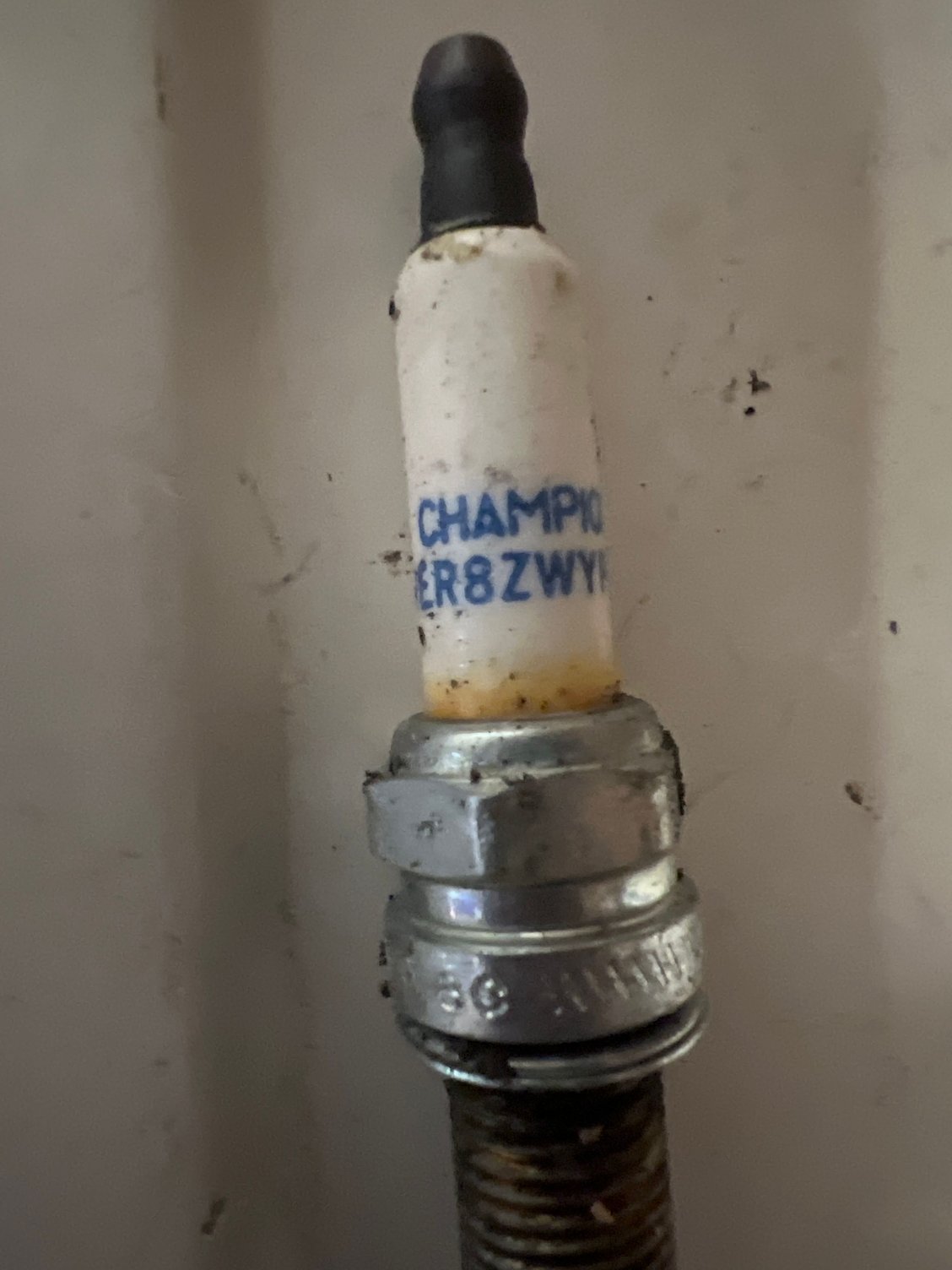

What plugs did you install? What plugs did the factory call for? I know on the older trucks, they came with copper plugs, and installing the rare-earth fellers has given some folks mystery misfires.....

Identical to these, which i believe are factory installed.
RER8ZWYPB4

Ok, those guys are iridium.... Looking at the replacement prices on the mopar site, yep. Rare earth were apparently stock.
Did you re-gap them before installation?? Were you having this problem before you replaced them??

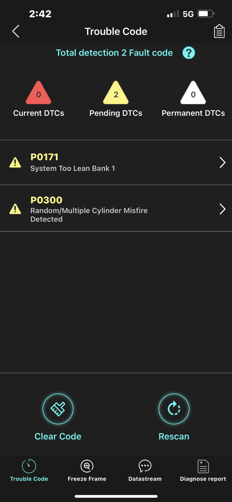

As far as codes go. But it's not consistent. Which one is cyclinder 1?

Bank one should be the drivers side, frontmost cylinder will be 1.
The system too lean code is the one you need to troubleshoot. Running lean will indeed lead to lean-burn misfires under load. Question becomes, is it REALLY running lean? Or is the O2 sensor getting lazy? Try unplugging the front O2 sensor for the drivers side, see if the problem goes away. (keep in mind, this will set a code too.... and make sure you tie the connector up somewhere that it isn't gonna get damaged.)

I did not mess with the gap. I did inspect them visually, the gapping seemed consistent.
the symptoms stared before the plugs but only under fast acceleration before, passing on the highway. They are now at idle sometimes.

If it were the MAF sensor, I would expect to see codes for both banks, but, that's not what you are getting. Try the O2 sensor test, see what happens.
know exactly where this sensor is located? Driver side or passenger side?
Old Apr 17, 2025 | 04:16 PM
Posts: 87,588
Likes: 4,237
Drivers side, somewhere before the cat converter.
