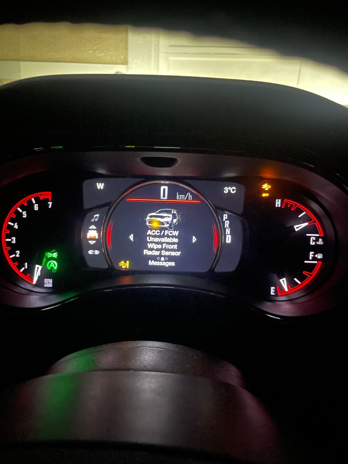

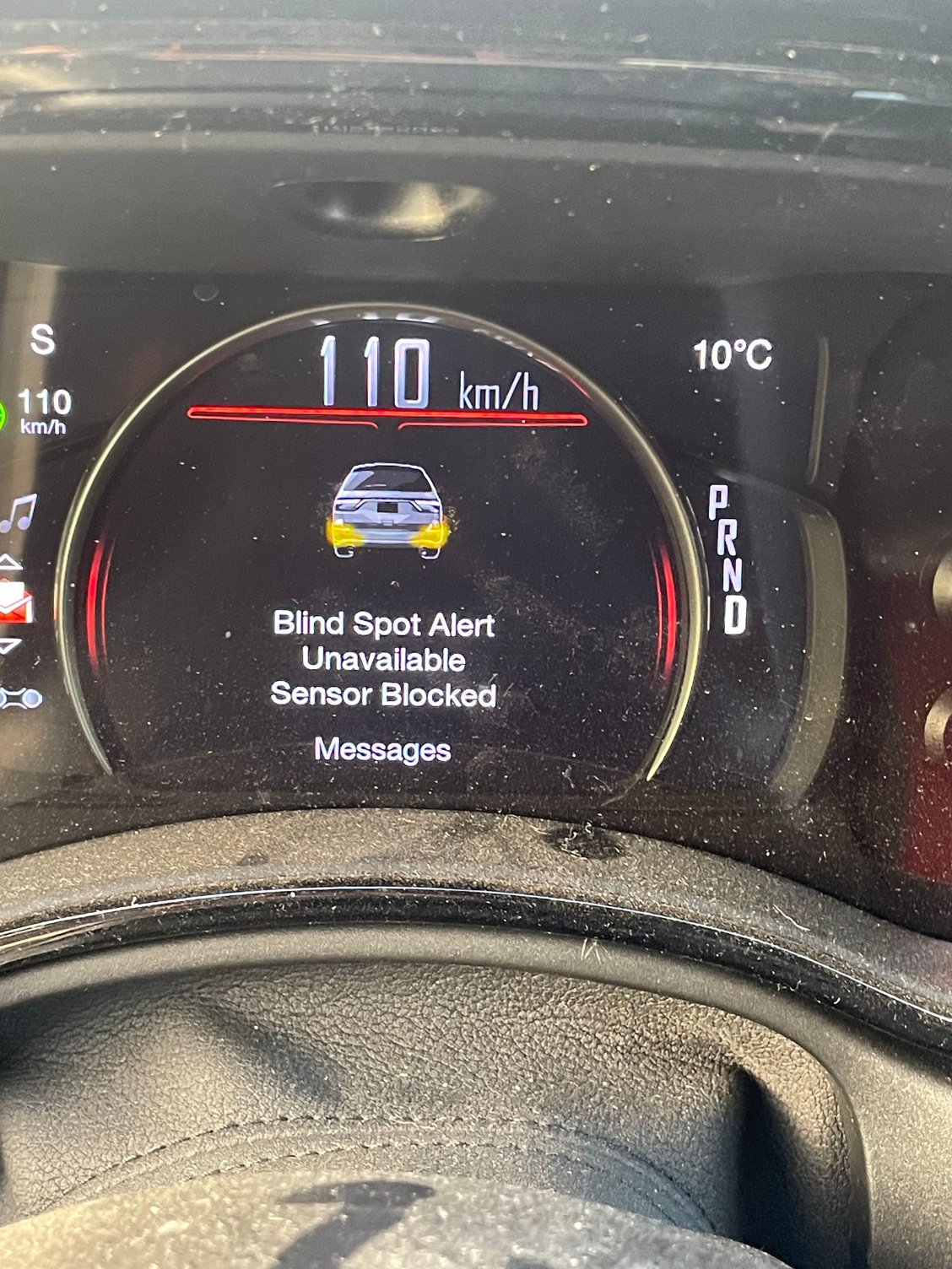

Hello, I was wondering if anyone has been having issues with FCW, radio, blind spot sensors,
Blind spot sensors failing

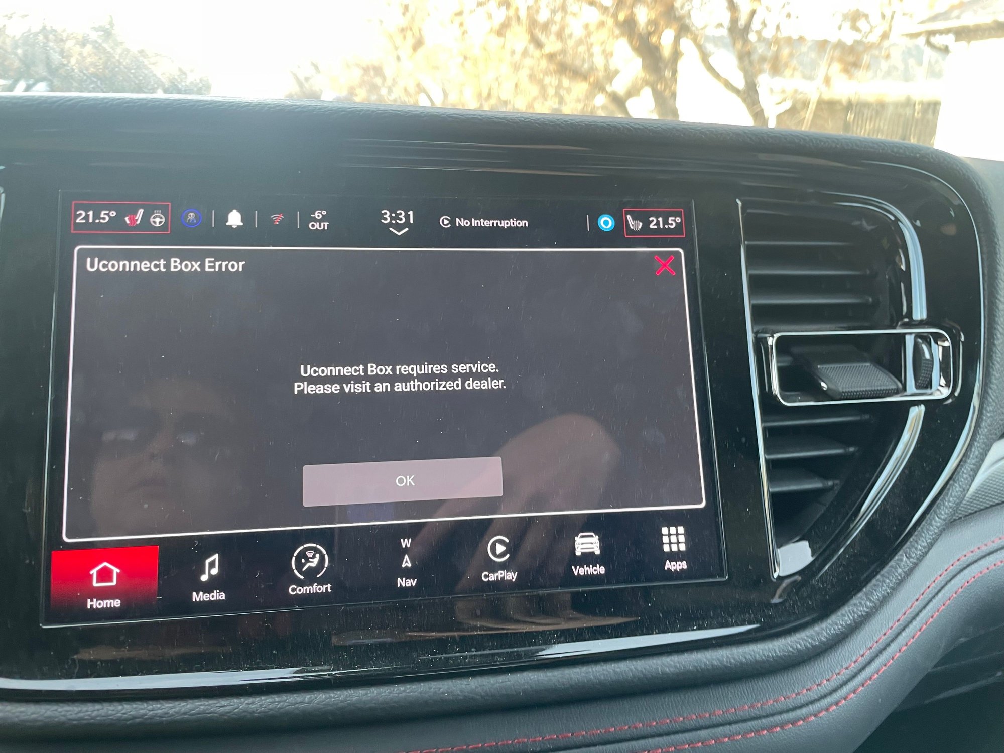

There are a few different radio malfunctions, this was the most recent.

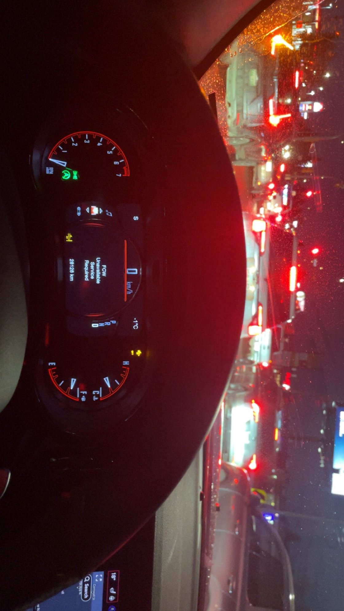

The FCW warning
The FCW warning
Happening in traffic

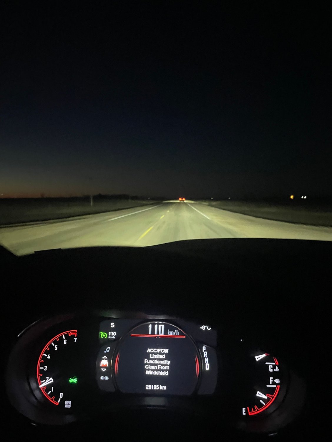

Notification that my windshield was too dirty...
and wipers? Mine has been malfunctioning since I bought it, I've brought it five times, and they admitted they can't fix it. Essentially, they've told me to shut up and wait until they figure out how. It's been a year, the relationship with the dealership has completely soured, and Dodge won't respond to me because the codes are self-clearing so apparently, I have no options.
The dealership was alluding to this happening to a lot of people. I was hoping to get a feel for if anyone else is having the same experiences.
FCW warning comes on every time I drive, they say it's because of remote areas but mine comes on no matter where I am. There is a new issue where my wipers will start going super-fast and then I get a warning saying that my windshield is too dirty, my windshield is never dirty when this happens. The radio will also fail; it'll go black and I won't have audio or access to things like my climate control. Warnings pop up constantly saying the vehicle needs servicing. Anyone have any advice?
