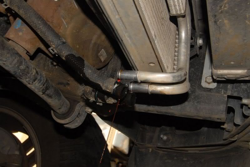

Locate the power steering lines going to the cooler

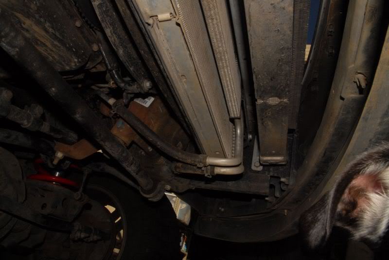

Remove the power steering cap to allow the fluid to drain freely

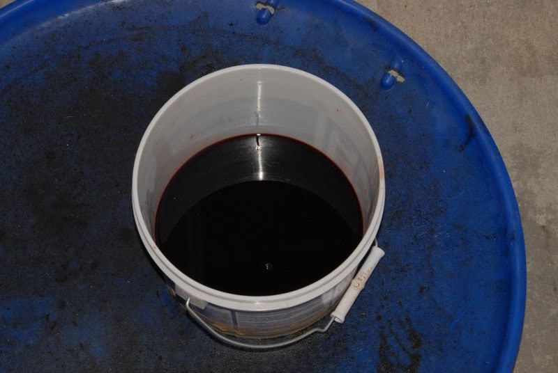

once it has stopped drainning, bump the starter a couple of times to move fluid along. I got out alot more fluid when I did this.
when it's done draining, replace both lines on the cooler
this is what I got out of mine... brownish in color (normal according to the manual)

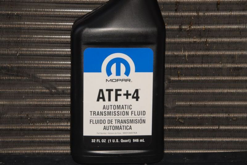

Refill with approx 1 quart of ATF-4 fluid (found at walmart for $4.46/quart)
