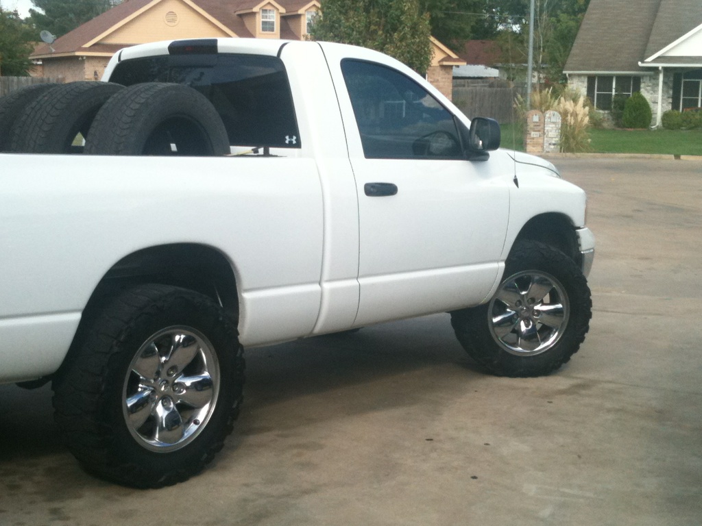

To all the Guys who wanted to see the 35/20 Combo here it is, the only thing i have for a lift is the T-Bars cranked up a little, yes i know the tires are bald i bought them for 20 bucks for 4 lol and them being load range E tires i knew i still had 10ply to rub through lolName:  35_zps5d246742.jpg

U have spacers on that

I have no spacers, These tire are 35/12.5/20 i simpily just stuck them on.
