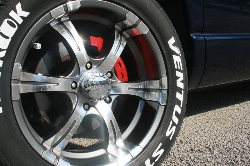

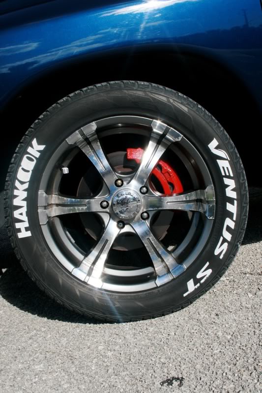

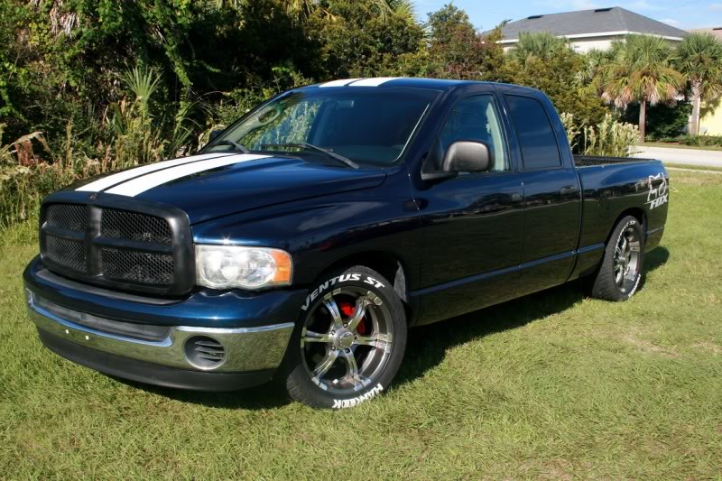

i painted mine with a brush.. didnt take them off either. just took off the wheel and went to town.
