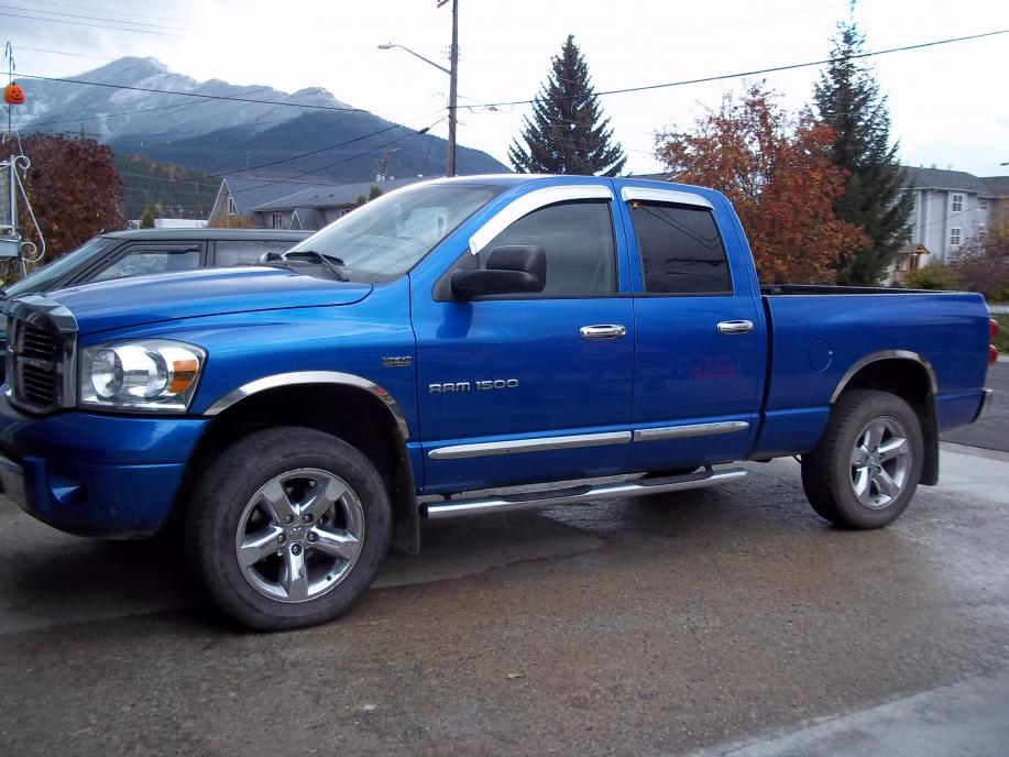

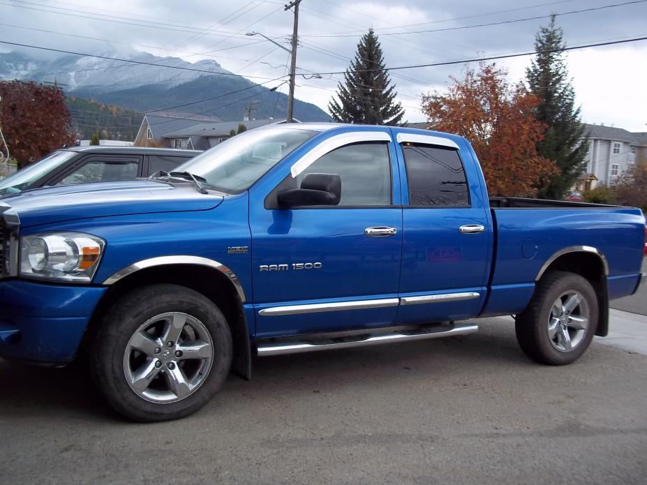

Love my new 5100's! The ride is great, but I don't really have anything to compare it to as the stock shocks were shot for awhile....but I love the built in lift. Went with the max height and now she sits level!(stiff)
More than happy with the results!!
