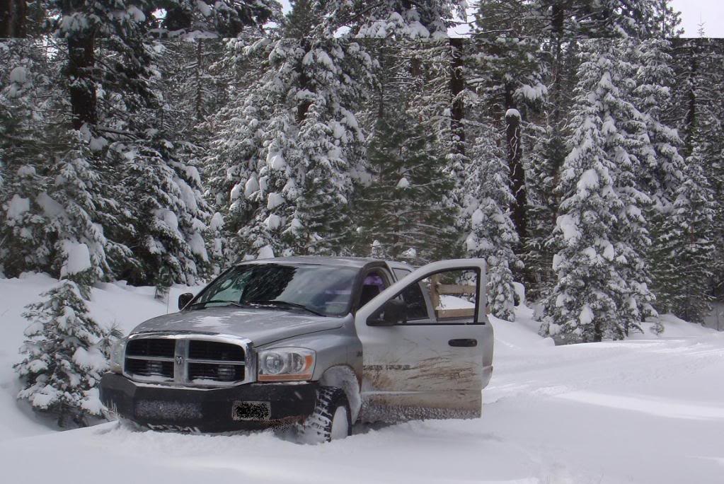

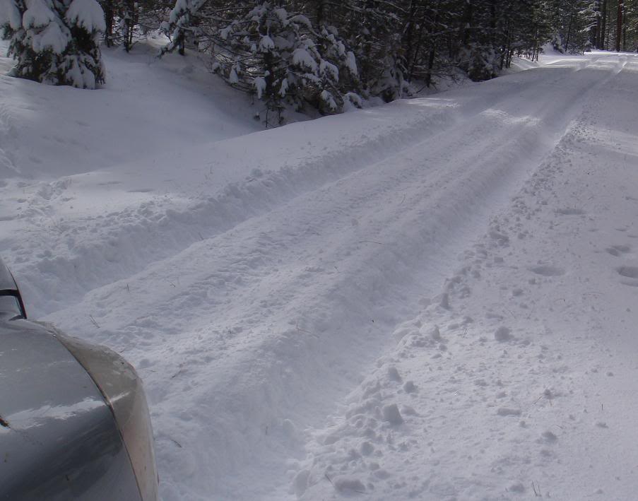

I just put bfg KM2's on my truck. and sofar they have done awesom in the Snow and do pretty well in the mud too.
Heres some pics in about 16"-18" (maybe more cuz in the pic you can see my bumper in the snow alittle) of snow mostly powder. Ive had it in 6-8" of wet snow to had no problems(thats the most wet snow weve had sofar).
These are listed as a Mud Terrain.
but they are really expensive for a 20" wheel..
mine for a 17" were $245 from discount tires with a full Tire warranty.
I have around 4K miles on them sofar. seem to being wearing better than my last tires.
