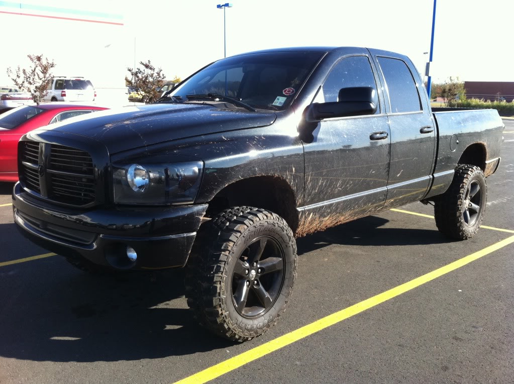

I dont know what your truck looks like i.e. color, trim, etc
but if I were you, I would do this (im somewhat biased lol) level, body lift, 18s on 35s. I would have this package on my truck but its all black http://www.rimzoneonline.com/product...570R18-Load-E/
now mine has 20s, they are the stock rims, but heres almost an exact idea of your stance with what i gave you, for less than 3k.
