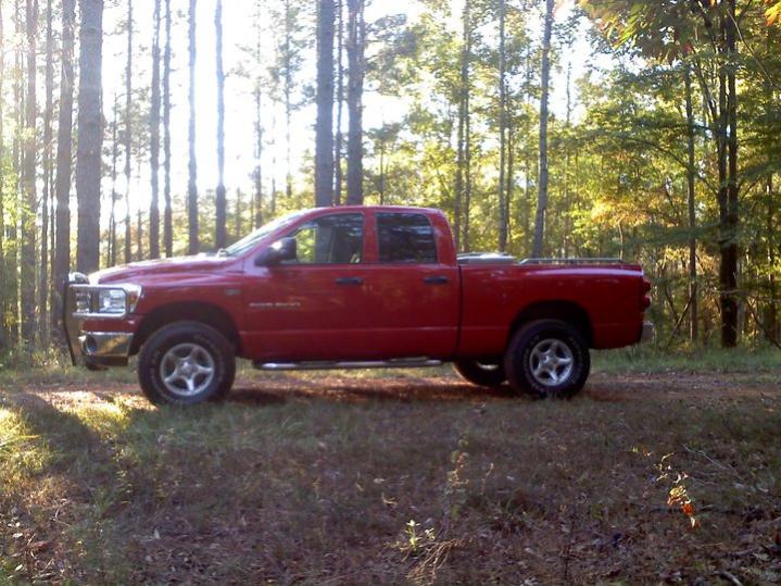

would this truck with these tires look okay with a 6' suspension lift? they are 35' firestone destinations...it has a leveling kit on there already
6 inch suspension lift help!-72216_173739905970549_100000036226809_637828_961605_n.jpg

Well, obviously this is a personal preference question... so you will get mixed reviews.
But, since you are asking for my opinion, I will give it to you. Yes.

yea i think itll look good. 35s will look kinda small with another 6in I think, a 3in suspension or body lift would be better as far as keeping the tires

Ya theyd look like they do now but with your truck higher...... soo i think theyd look small and ud usally go with something a little bigger and aggreassive, but even if u got some nice agressive 35's it would look good, i think the key for tires to look good is tread going over the side of the tire(side lugs) here are the ones thats are real popular on the market right now

Don't ever combine a level kit with a suspension lift, you will blow your CV axles. Too much angle. Either pull the level kit and install a suspension lift or keep the level and add a body lift...

Maybe just a body lift then so you can keep it level and go with those 35. You got my vote for it.

im not gunna keep the level kit on there with the 6'. it woud just be the 6' suspension lift
Old Jan 22, 2011 | 12:29 PM
HammerZ71's Avatar
HammerZ71
Posts: 24,686
You'll be fine then, just try to pick a kit that says they keep the CVs at close to stock angles...
