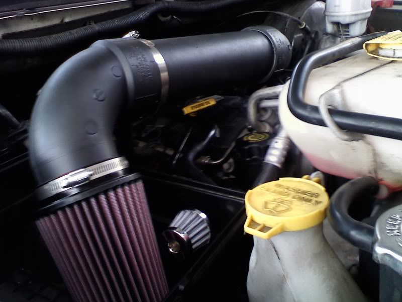

Small cone filter that is about $7 at an auto parts store is fine...
Here is a good shot of one of the CAIs I made for one of our members:

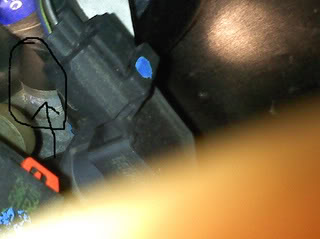

It actually run back to the top of the block. To the left and behind the throttle body. The rubber reconnects to what appears to be a steel nipple sticking out of the top of the block. Rubber 90 at the air box and another rubber 90 where it reconnects to the nipple in the top of the block. Sorry best picture I could get in that tight spot.

No I have a 4.7l magnum. Yea wierd, it 90's out of the airbox, goes back about 24", and has a rubber 90 again that connects to the nipple out of the top of the block.

Hammer Z71 can you tell me just what the line that you put the little cone filter on is? And what it is it hooks into on the back left of the block?

By golly that may be exactly what it is. Makes sense being as it runs from the airbox to the position in your diagram. I see no reason why I shouldn't be able to do what Hammer said. Not that I didn't believe ya Hammer.
