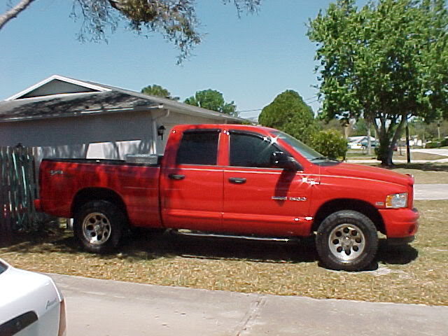

That tire size would fit even without a level. It will be just fine with a level.
My truck way back in the winter of '04/'05, prior to most of the work I've done, with 33" Mickey Thompson tires that measured almost identical to the 32.7" tires you are wanting. Front keys are cranked about an inch and a half in the photo, so it should give you an excellent idea...
Rake is very slight, it just looks like a lot of rake because the yard is sloped...
