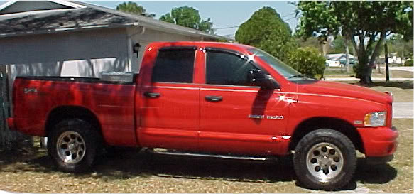

They will stick out MORE with the DC2 wheels by virtue of their backspacing than the stock wheels do. The exact opposite of what the guy is telling you. Besides, it's the width of the tire that hits internal steering components when they do rub - sticking out more moves them FARTHER than those components.
NOW, granted I have a torsion front end which yields more room for wider tires and had you said you were going to mount the 12.5" tires on the stock rims, I would have said it be close, might just scrub a bit at full lock, but with an aftermarket wheel with 4.5" of backspacing (negative offset) you will be fine.
When you go to 4 Wheel Parts, smack the kid for me...
My truck in late fall of '04, 33x12.5x17s, now this is with the Mickey Thompson Wheels - Identical backspacing as the DC2s. Suspension fully stock - notice the rake?
