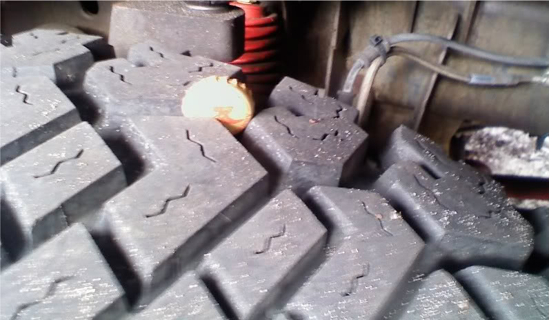

Mine at 31k:
I expect to easily get 60k miles out of these tires.
