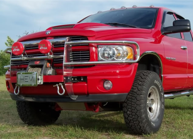

35"x12.5"x17s, 17" Mickey Thompson Classic II wheels, 17x9, 4.5" backspacing, -12mm offset. My tires stick out about 2-2 1/2" outside the wells...
