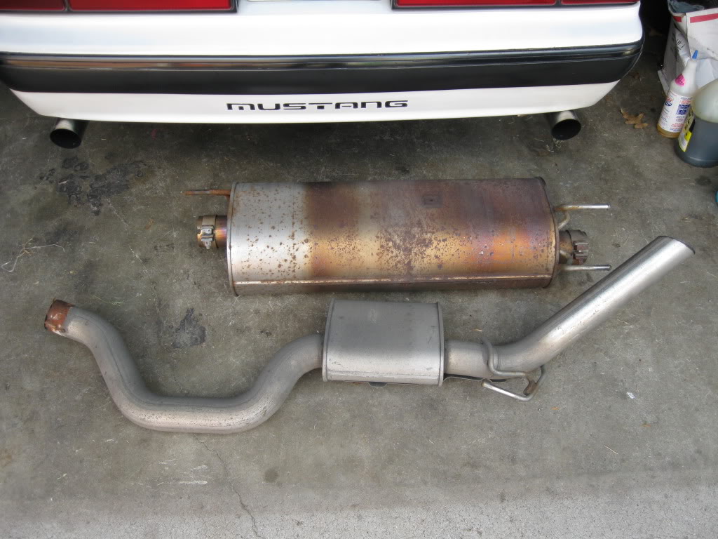

Yep, 06/07 have the front resonator, 08 only has one.

I just removed the muffler on my 07, leaving a small resonator (smaller than in lxman's picture) and it is just too loud. I didn't even stomp on it and the truck is loud. Guess I'll be putting the OEM back on for a while...
