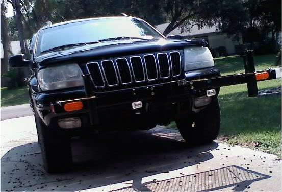

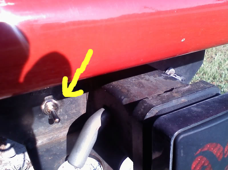

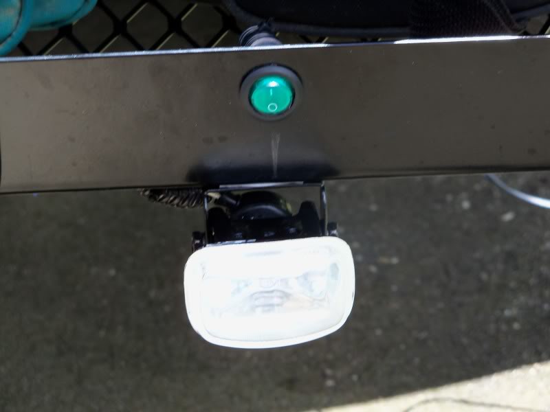

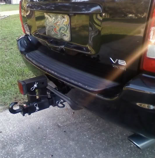

Well, what I did was more for when I'm fishing the riverbank when I have my truck, we pretty much park on a sand bar and fish the night, often setting out limb lines, noodles then heading back to camp and sticking a few PVC rod holders in the sand and casting out a couple rods. It's a bi*ch re-tying, etc. in the dark and I use the tailgate to hold my tackle. So I made one to slip in the reciever, but that won't help when trailering. I wired mine with a switch, tapped into reverse lights and ran a wire for constant power. When the switch is off - they are reverse lights, when the switch is on - they are constant on.
I kinda wish I had thought it out more and made them able to be used WITH a trailer. I may make a set that slips over the hitch or pick up another 2 to 1 adapter like I have on my Jeep.

Yeah, I can understand that. I wanted the switch right there at the lights so I wouldn't have to walk up to the cab to turn them on when doing something behind/at the tail gate of the truck...
Now on the front lights of my Jeep, I have the switch inside, but for my winch lights or fishin' rig lights I have a manual at the lights as well, so I can switch them off/on up front when I want to.
