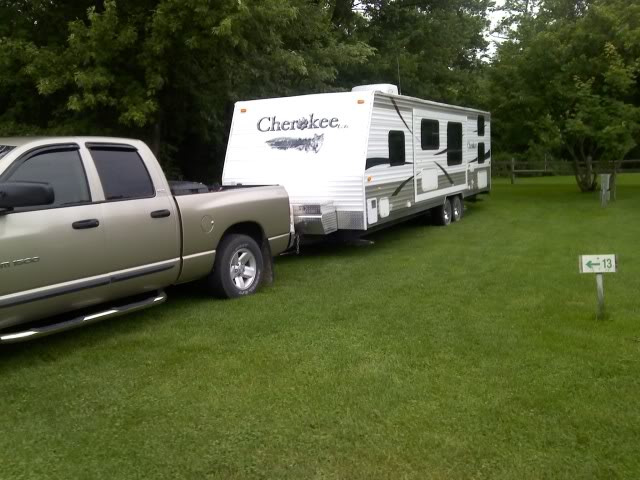

OK guys here's your "holly S#!t" moment. Wish I had a CTD.
The wrong...1/2 ton pulling a 7000 lb trailer with a 5.9 gasser and 3.55 gears.
The right...I have a WD hitch, trailer brakes and most camping is done within 20 miles of home. (And I don't race to the campground)
