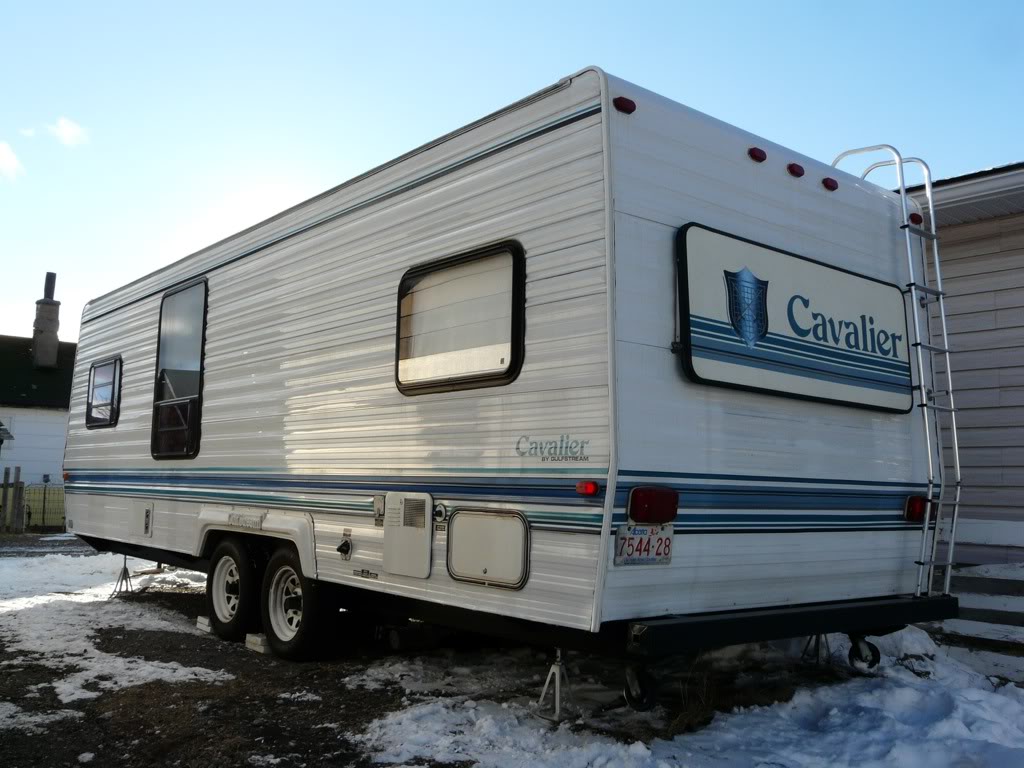

Thansk for your replies. I checked the numbers on the camper. 6600 gross weight, and it has a weight distributing hitch. Tanks are behind the axles.
I live in the Canadian Rocky Mountains, to get west I have to climb some hills with truck and camper, probably I should invest in a tranny cooler and gauge...
We have lotsa wind here, too. But you know I don't have to drive very far to get to a nice spot. I can camp out in the backcountry here which starts right at the border of my town. We've got a nice lake with nice camping two hours from us. Not too much elevation in between.
I can see the pro's of a Diesel but unfortunately I'm on a tight budget here, so it's outta question. So what I'm looking for is either a 1500 or 2500 Hemi. Hope it'll do the trick and it will get more than 7mpg towing the camper.
