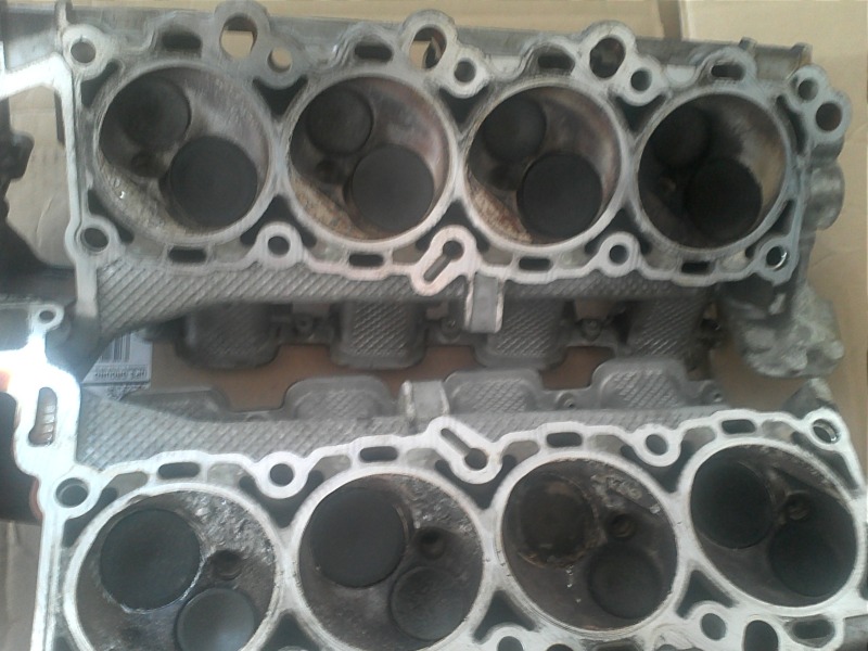

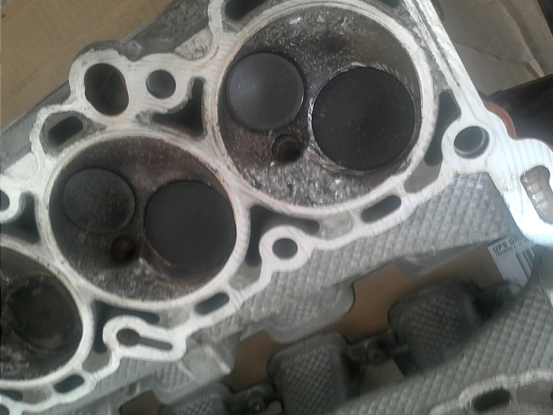

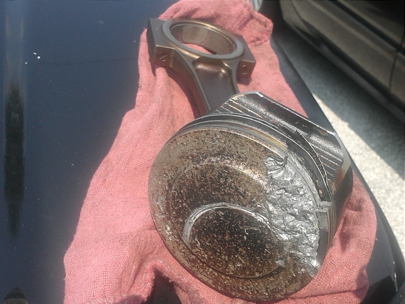

Is what happens when you drop a valve seat:
4.7 engine with barely 100k miles on her...
I'm not too familiar with this problem, so basically does the valve seat break off from fatigue failure and fall into the cylinder damaging the piston and cylinder?
Old May 30, 2012 | 09:29 PM
HammerZ71's Avatar
HammerZ71
Posts: 24,686
I had never heard of it happening either until after it happened to me I did some digging and found it's fairly common. Quite a few posts on Jeep and Dak sites about it and I've found a few Ram owners but not many.
It seems that over time the aluminum heads expand and the pressed on steel valve seats obviously don't and when this happens the seat just falls out. Over-heating can also cause it but my Jeep (even when my radiator split) never got over 220* for the six years I've owned it.
I have found out from one of our moderators who is a Chrysler tech and another tech who is a friend that a lot of time when someone overheats the heads warp and the head gasket goes and they find dropped valve seats, but the owner never really knows about it as the heads are replaced anyway.
Now I personally know guys with 4.7s with well over 200k miles on them, so I wouldn't panic it if you own a 4.7, BUT the pressed on steel seats obviously can fall out. Most engines have a C-Clip holding the valve seat, Daimler when they owned Chrysler and designed the 3.7 V6 and 4.7 V8 deemed it only necessary to press fit the seats. Again this happens mostly when overheated, but not always.
It's about as common as failed valve springs on the Hemi, so it happens to people, but not so often that it'd be something to panic about...
I will say one thing though. It's the LAST OHC modular engine I will ever buy. Not that I've lost trust in the 4.7, but pulling the heads is an outright ordeal! EVERYTHING must come out to get to them. I've pulled the heads on a 4.0 I6 and it took two hours. This took TEN!!!

With a piston looking like that.... I would replace all of your crank and rod bearings! Atleast check them and plasti-guage them.
