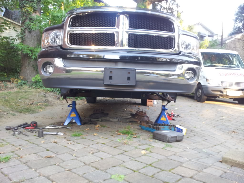

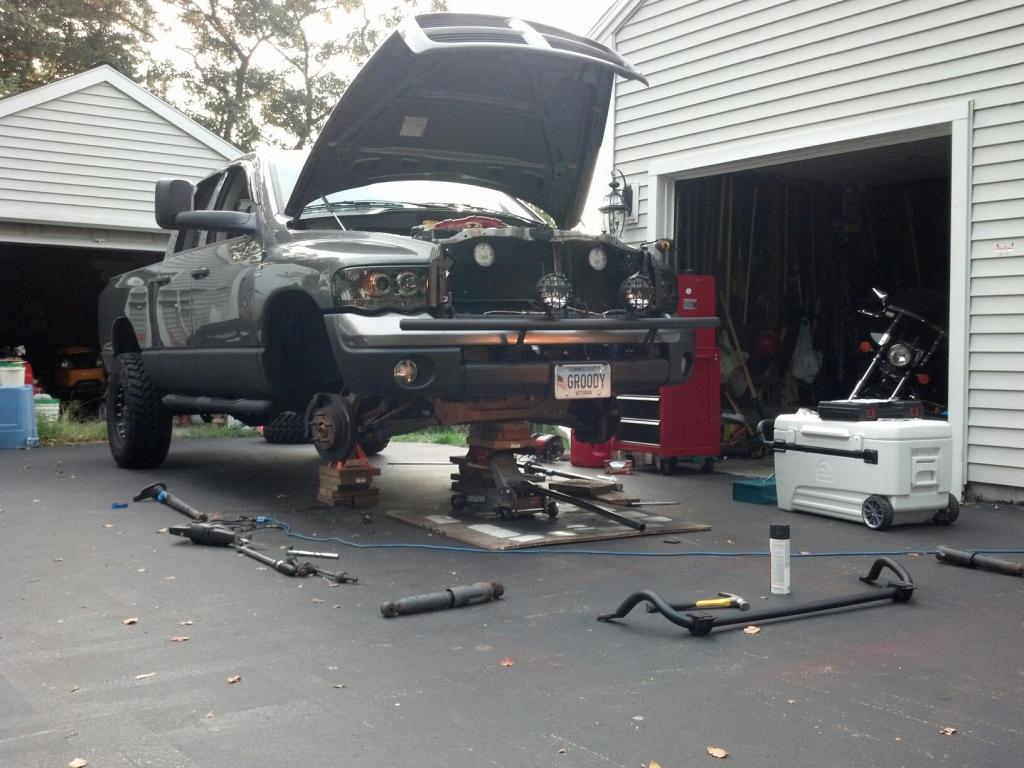

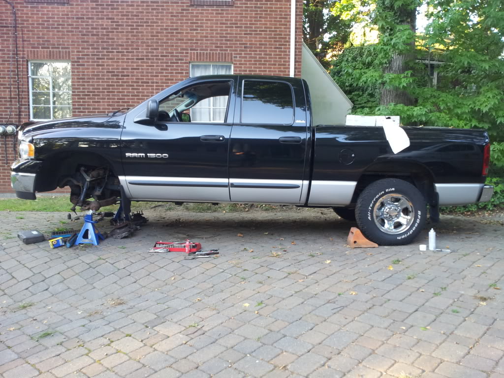

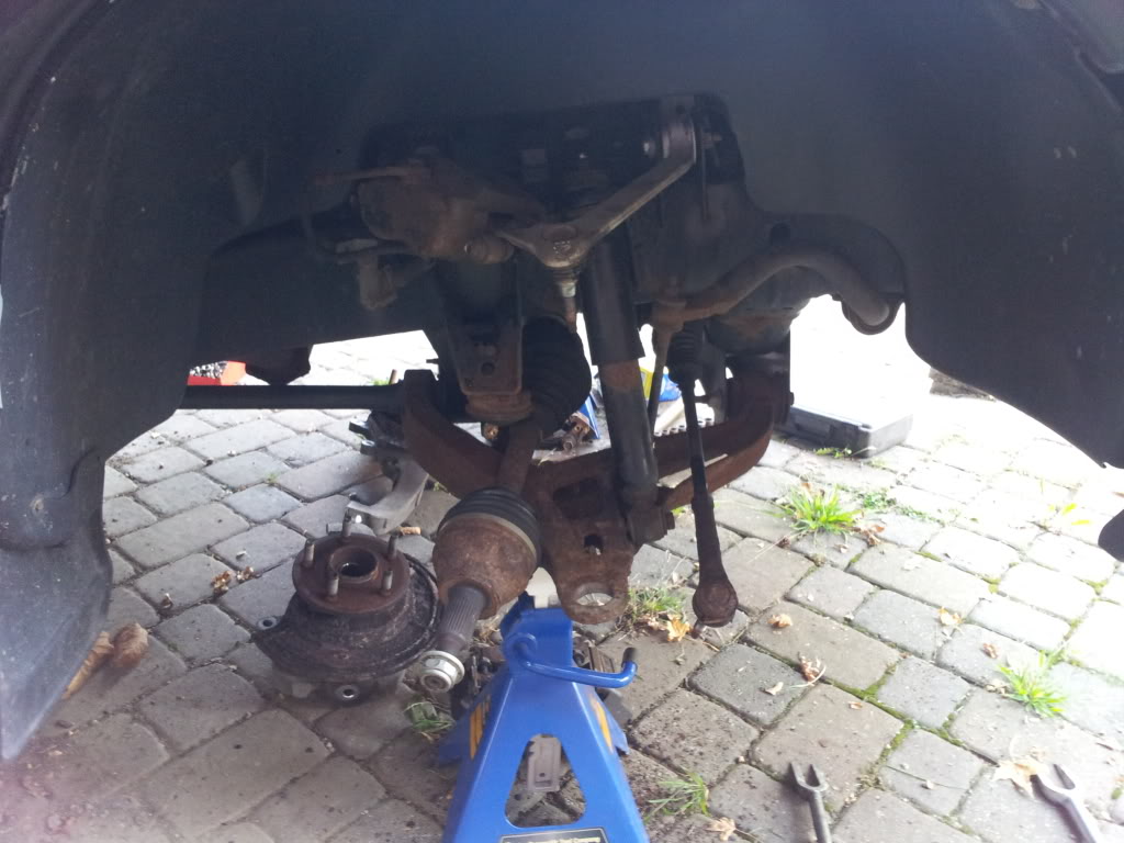

As the title states this project started out as a simple maintenance job. Once it was off the ground I found a bad lower ball joint. Off came the front wheels and I noticed both outer tie rods with the boots wide open. Then there was a slight leak in the steering rack. Given that the truck is almost 11 yrs. old I decided to do all the ball joints, rack, tie rods, swaybar links, bearings, as well as brakes rotors and shocks. I also ordered new halfshaft assemblies too. Going to turn up the tortion bars too.

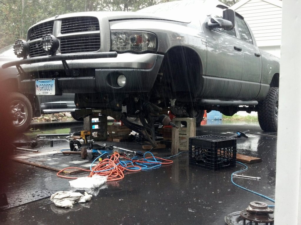

Reminds me of installing my lift!
