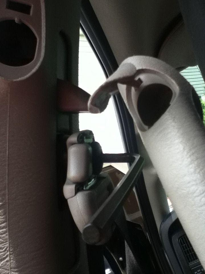

ok first what I did was take off the tan moldings.
Just pry the holed open with a screw driver and use a 10mmsocket to get the 2 screws out. Also do this for the back 2 handles. These twopillars were a little tricky to get off. In the front by the windshield and onthe dash there are 3 inserts where it is still connected and takes a little playingaround to worth them free.
