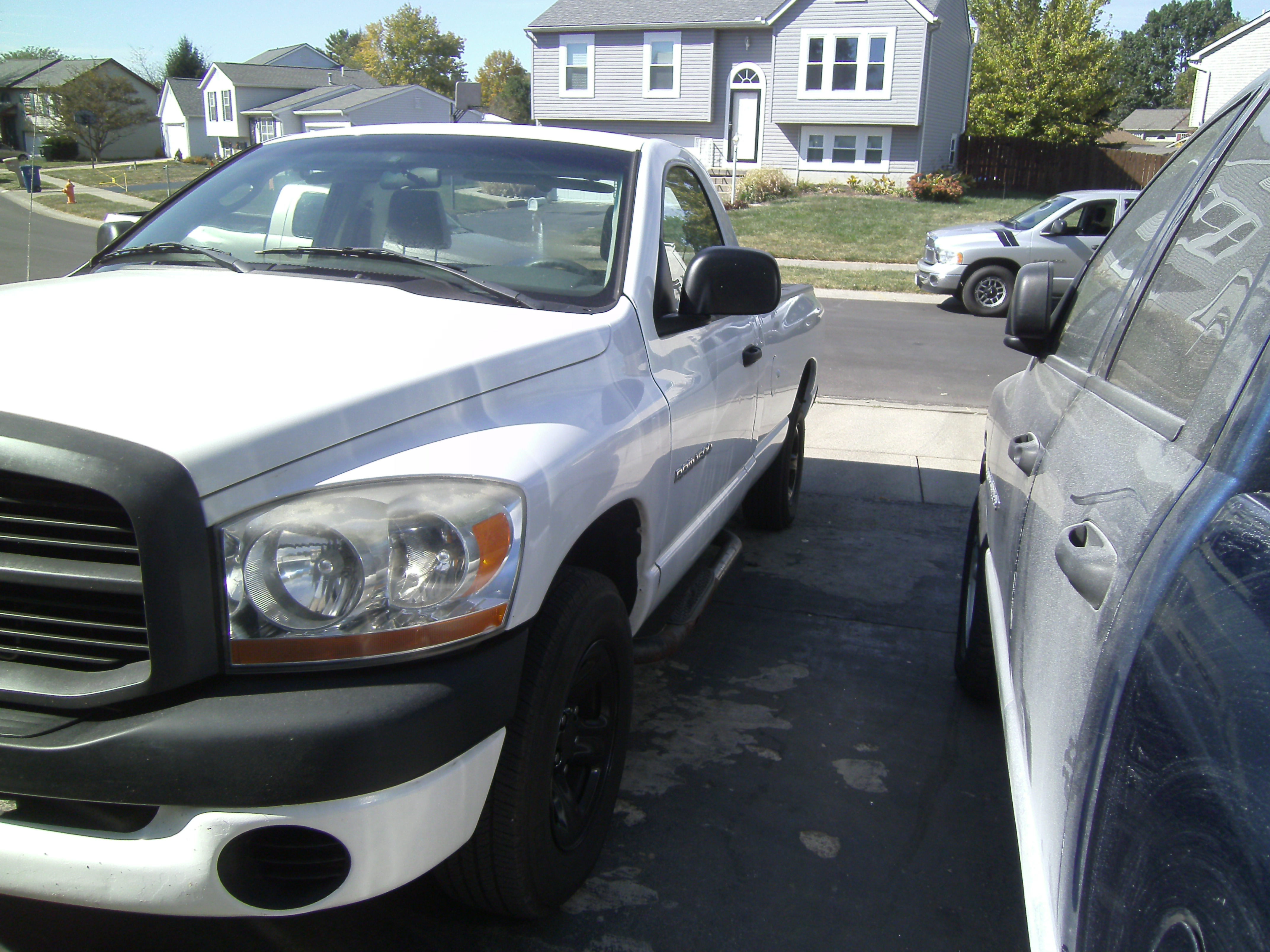

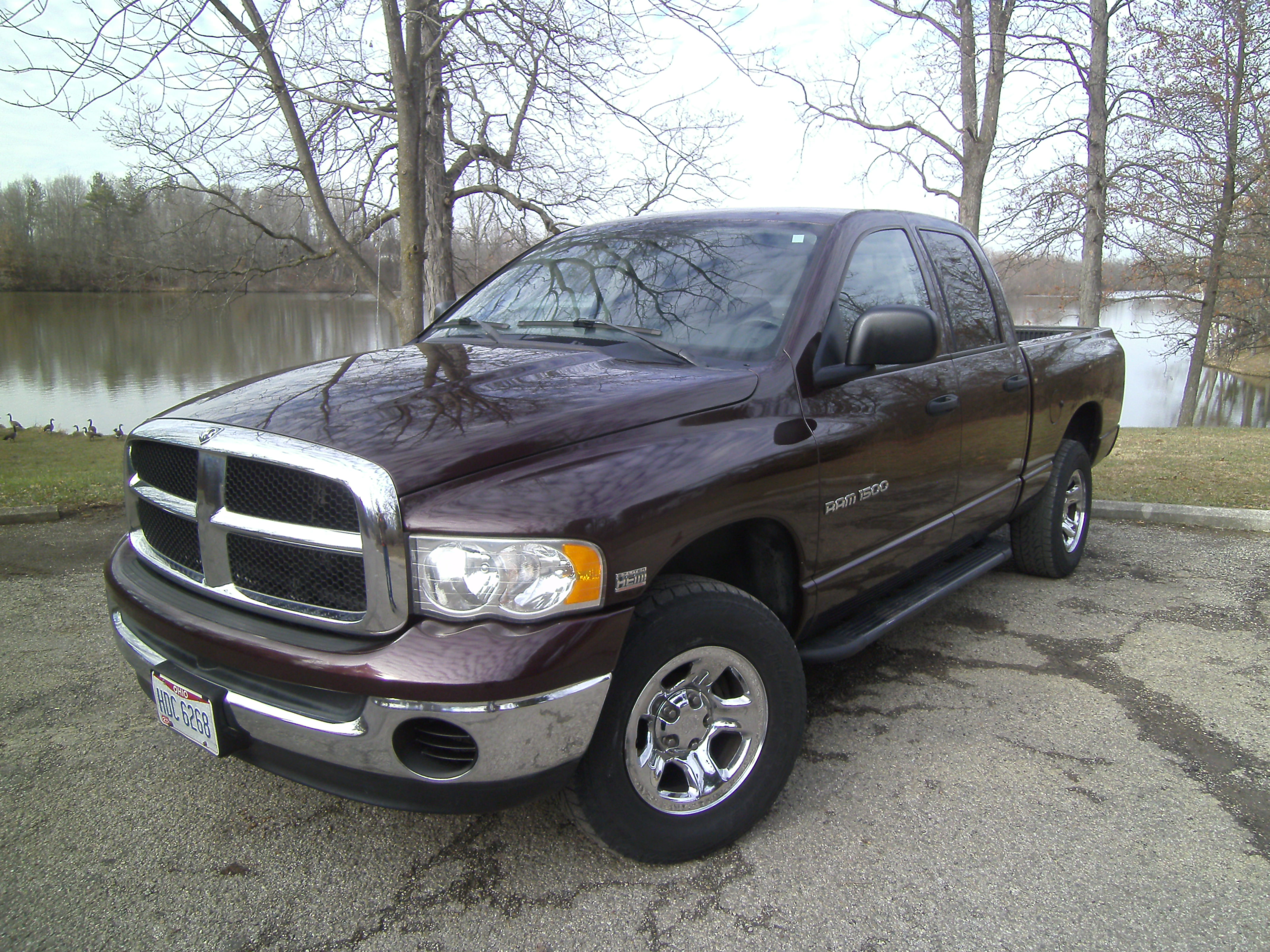

some pictures of the trucks
redish truck is the 2004 i just got
blue truck is the 2003 i just sold
white truck is the 2006 that i drive currently
Attached Thumbnails bought another ram with motor problems-sany0372.jpg   bought another ram with motor problems-sany0325.jpg   bought another ram with motor problems-sany0341.jpg
