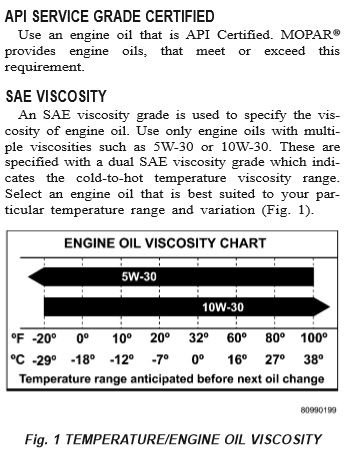

I'd run 30 weight, and probably the high mileage version for better additives. Seems smarter to go with the 10w30 if cold temps (below -20 degrees Fahrenheit) in your area are over until the next service.
Here is what the factory service manual shows for 2004:
