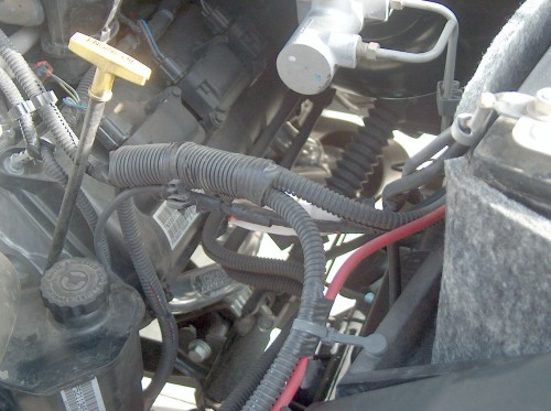

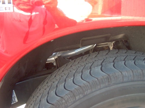

Here's a couple pics
They tuck in quite well. Didn't bother to take one of the right side as you can't see it.
This is about the only way anyone will know what you have.
