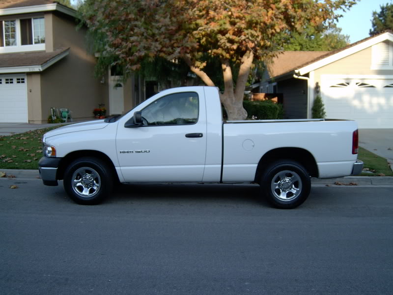

Finally saved up 500 bucks and bot the 3 inch spindle lift from rough country from Topguncustomz.com
Before
After:
The Picture may not give it justice but its much nicer. The small stock 29s look like crap but larger ones are soon to come...

since it was just a 3 inch drop spindle, installation wasnt bad at all. Take wheels off, caliper pads etc, then rotor dust shield etc, then spindle. The ball joints needed to be hit a few times to come loose but everythin else was flawless. kit fit perfectly but it messed my alignment up horrible. the toe end was far from ok to drive with so it took another hour with chalk marks and a tape measure and rollin in forward and backward to get it in a driveable range. Took it to a pal tues and had him fix my alignement job which was safe but not exact. the ride with the new shocks feels a little stiffer but its not bad. Very pleaseeed will look great with some 33 inch tires and hopefully new rims if i can afford it.
