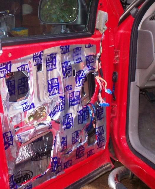

Yea...That looks all to familiar.... I did the same to mine, pulling out all of the carpet and laying a couple of layers of FatMat... I got 100sqft for about $100, then used some Dynamat extreme in the problem spots like the bottoms of the doors. I only get a nice thud when I knock on the door, not the normal tin can sound that it had...

Here is the matting on the inside of the doors, you can see the Dynamat Extreme in the bottom....

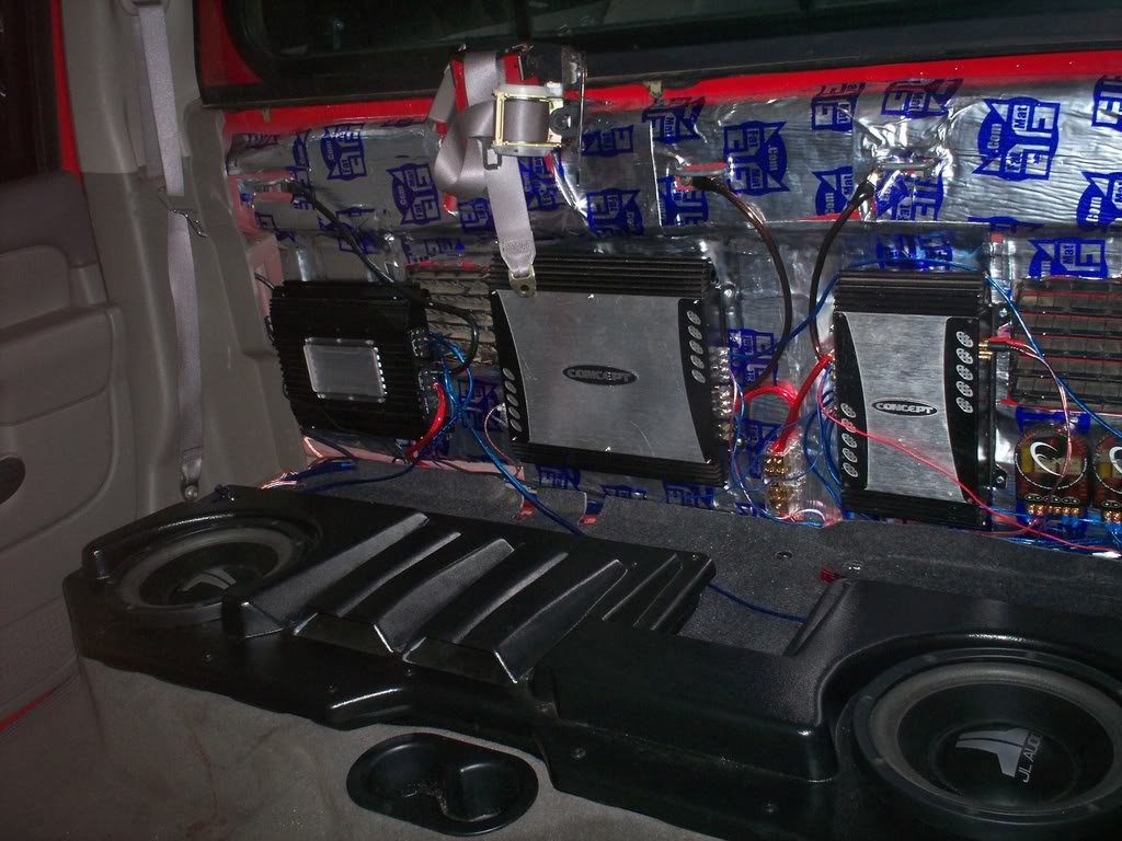

Here is the back wall with the amps...
