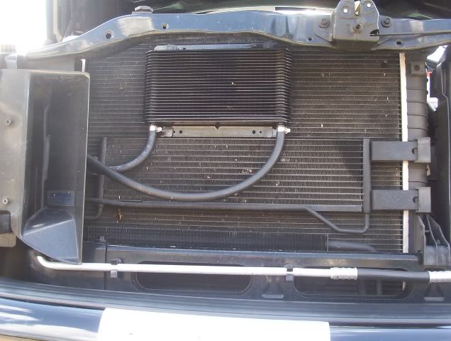

Here is the secondary B&M tranny oil cooler I am running from Summit.
http://store.summitracing.com/partd...+0&autoview=sku

Does that one seem to work pretty well for you helo?
Old Mar 20, 2008 | 06:00 PM
helopilot's Avatar
helopilot
Joined: Aug 2005
Posts: 433
Default RE: Tranny coolers
ORIGINAL: motorider228
Prior to the cooler I was at times near 250 degrees towing a large travel trailer with a 2700 stall in 110 degree weather. After installing that second cooler in-line it never got above 190.
