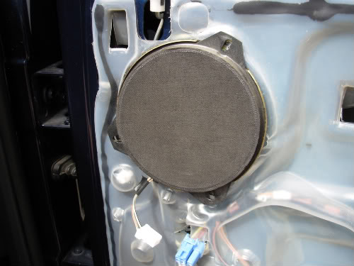

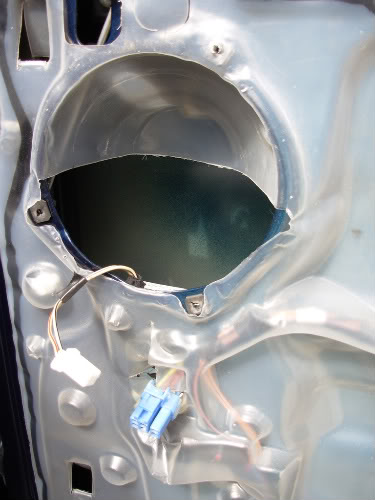

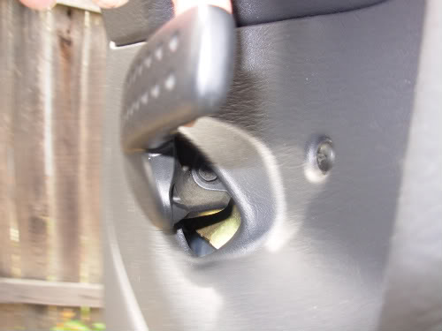

/\ /\ /\ Yup! I did the same thing in the front with the 6x9's and I ordered some Pioneer 61/2 4 ways for the back...they should be here tomorrow... I’m hoping they will be as easy as I am told they are to install... Just replacing the front doors sounds a lot better than the stock crap. Order some off crutchfield; they will give you the directions for installing a radio, and the speakers for your vehicle for free, and the wiring harness so that you can plug the speakers right in so there is no cutting or saudering wires. If you use my referral code: pc4be-i1auu-w0guc) you will get a $20 credit on your first order of $200 or more (if you are a new user)
Updated 4/1
I am in the process of drilling the new holes now...
Remove the handle Torx Screw T30 and the Philips screw on the door panel. Then the door will come off by pushing it up.
