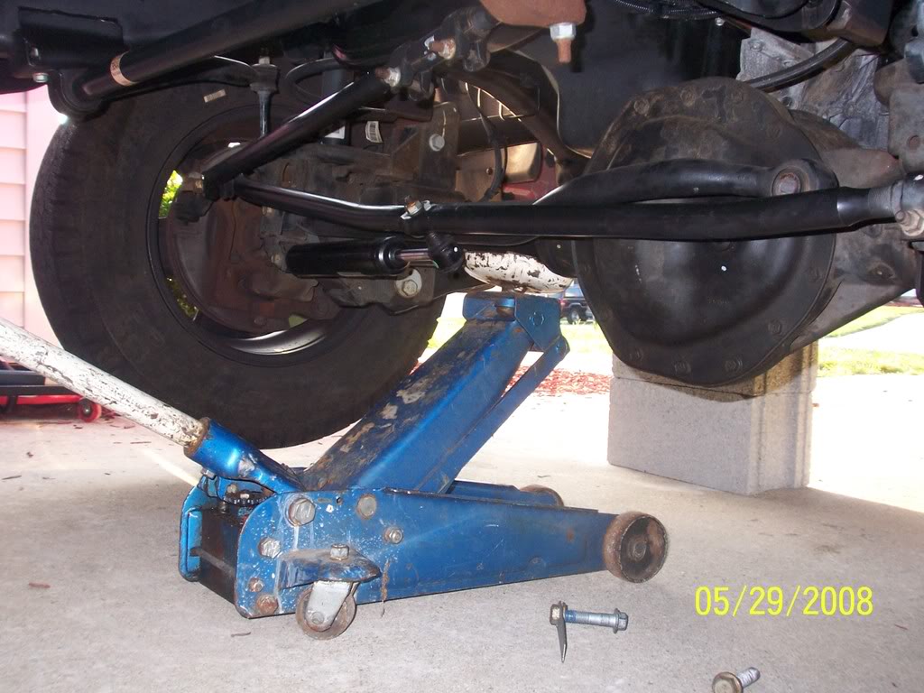

I just added a 2" Leveling Lift Kit from top gun customz and I want to share some of the pictures I took.

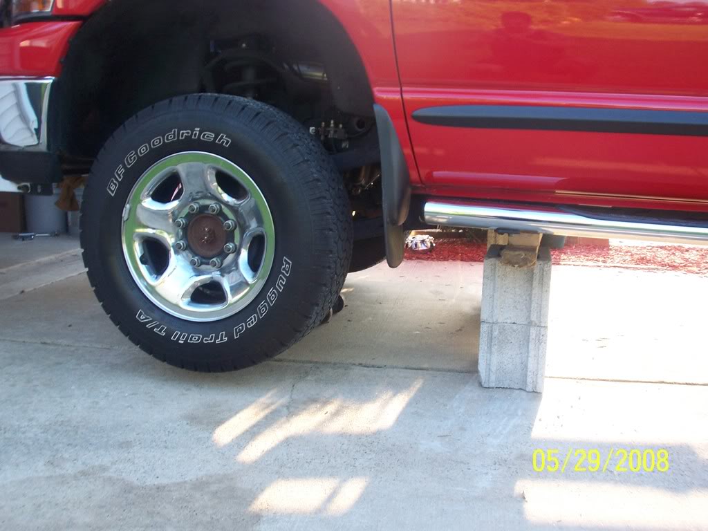

I did not wannted to spend money on the jack stands cause I probably would never use them again so I went to lowes and got me for blocks @ $1.35 each

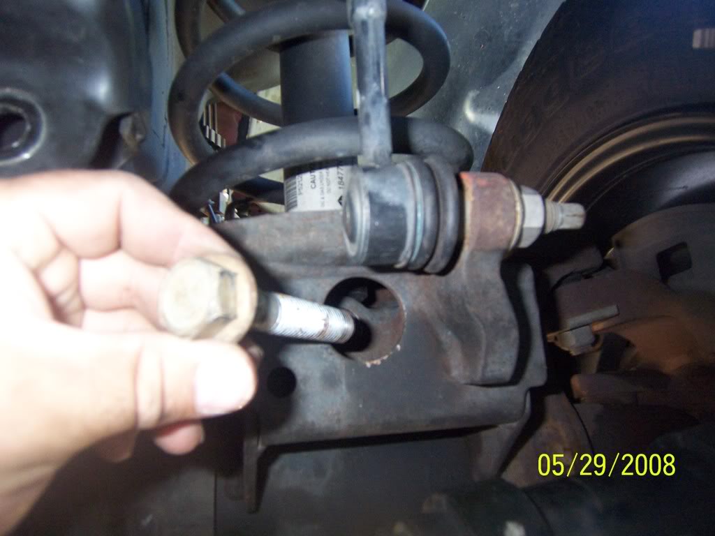

Just removed the track bar bolt

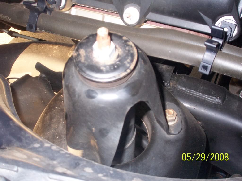

Remove vent line and three nuts from shock tower and remove shocks and tower from truck

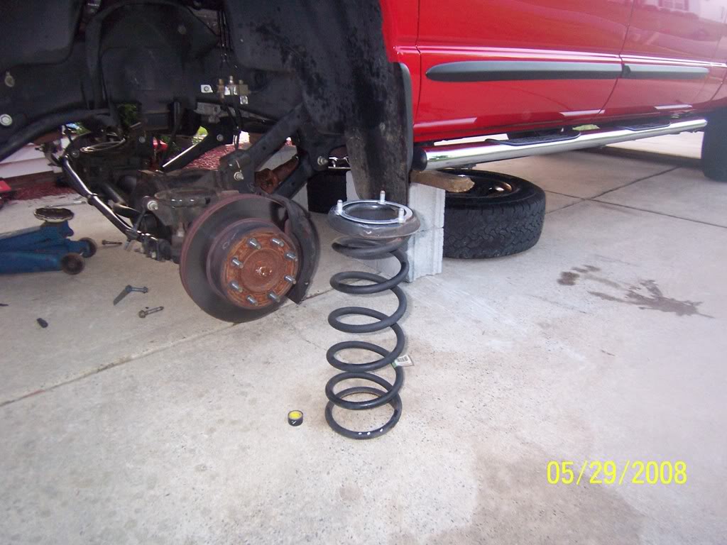

lower the axle and remove the coil springs
now you may need to compress the coil springs in order to put them back with the new spacers, here is I did, after I took them off I had to put them back without the spacer on and jack my truck up so the springs will compress, after the were compress I tied them so the would not uncompress once I lowered the axle and I'll be able to put the spacers so I did it and it worked.
after you do this just start put everything back were it was and you are done next take it to a shop for alignment.

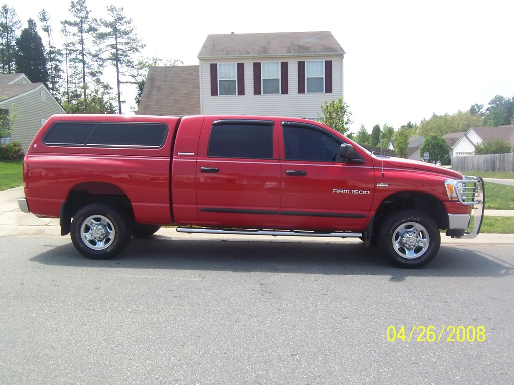

Before
After
Before
After
