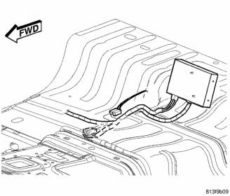

this is out of the service manual...
REGULAR CAB
Disconnect and isolate the battery negative cable.
Place front passenger seat in the forward position.
Remove the mounting fasteners.
Disconnect the antenna cable and electrical harness connectors.
Remove the satellite receiver.
See attached pic.....

Omg its under my seat ...LMAO Thank you !

Hey Parts/service I checked today and the reciver is not in that location. I give up
