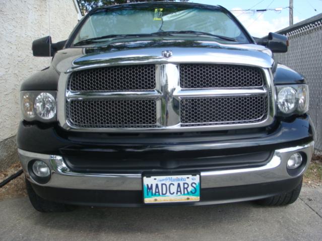

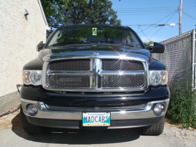

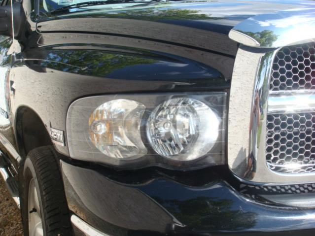

I was bored this weekend so.....

Looks good, madcars. How long did it take you & did you have any problems?

looks good. I still have to do that to my other set of headlights. what paint did you use? I'm thinking on flat black for mine. and what tape did you use to tape it off?
From start to finish about 24 hours, but there was yard work and beers involved.
Actual time 6 hrs give or take.
I followed the DIY for the most part, but soaked the tape with WD40 to get it off and it just fell right off.
Took a bit to clean them but well worth it
I used "painters touch" paint, it was just sitting around here, semi gloss i think. did 3 coats sanding in between each one.
I used the purple delicate painters tape, took longer to mask off then anything.
If your gonna do it take your time, that chrome is VERY THIN
