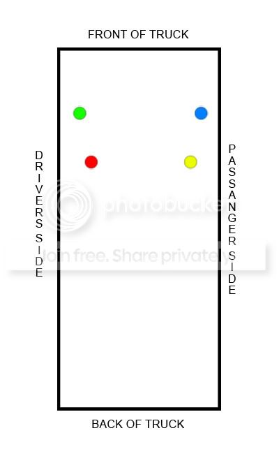

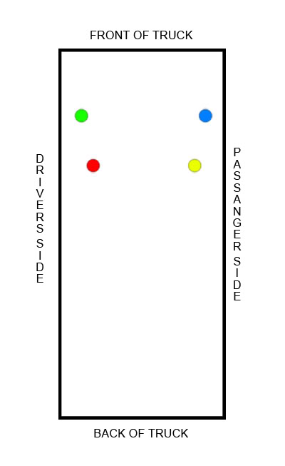

okay, I kinda get what your saying, I am not a big car person but I made a layout of the truck, lol haha dont laugh at it -=)

here is the direct link to the image:
http://i394.photobucket.com/albums/pp28/...
the 4 colors dots = the oxygen sensor, what color dot is the oxygen sensor 2 in bank 2?
The Blue?
The Green?
The Red?
or
The Yellow?
Thank you for your help...
Old Oct 6, 2008 | 02:33 AM
lxman1's Avatar
lxman1
Site Moderator
Posts: 9,657
Likes: 24
From: Louisville, Ky
Yellow
