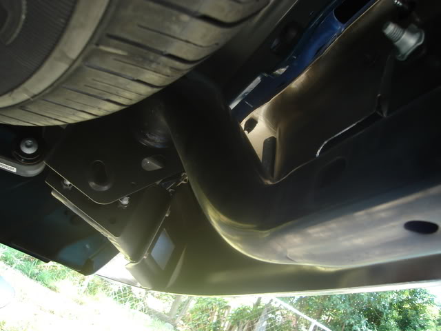

All rams came with a two part class III hitch (it's bolted to the frame and tucked under the bumper)...if you have the receiver bolted to the bottom of it then you have a class IV.
This is what it looks like without the receiver that all 3rd gens have...most get the receiver from the factory so they never know the difference. As you can see in the pics, you could but a ball through the middle hole in the bumper and pull with a class III rating since the weight is actually on the hitch...not the bumper.

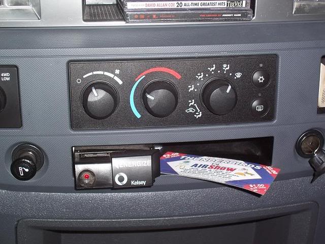

Here's where I mounted my trailer brake...
It's handy if you have the space and beats hitting your knee if it's mounted under the steering column.
