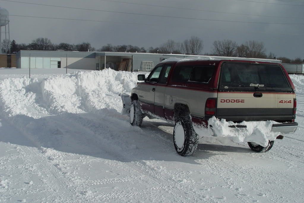

Seriously though, after driving and experimenting with different vehicles for more than 30 winters, it's a no brainer. We measure snow with a yardstick, not a ruler here. You want to go, add some weight over the main drive axle, you want to sit and spin, don't add any. Simple physics, in any appreciable amount of snow, the majority of the vehicle weight (engine) is on the front end burying it up in the snow, the rear wheels will just spin.
I don't put any weight in my 3rd gen because we rarely drive it in the winter here. It's fun to take out once in a while and do doughnuts or powerslides, but that's about all it's good for empty. Even way to squrirely with extra weight and my lead foot. Those stock 20's pushed by a Hemi with LSD just suck in the deep snow. Wifes Front WD Cirrus sticks to the road, and will get up and go better than that truck.
My second gen is a whole different story. Started out in '96 with just the added weight of the cap and about a 150 pound tool box. Damn, that was scarey. So in '97 I tried 480 pounds over the rear axle....difference was like night and day! Never looked back. In '99 I added a 600+ pound plow, and ever since, upped the weight in the rear to 640 pounds + cap, +tool box. That baby is unstoppable now, just digs and goes. Yeah, it may burn a little more gas hauling the extra weight, but probably equal to the amout I'd burn spinning the tires trying to get the hog moving anyway. And actually I think it's stops better in the snow with the extra weight.....but not so much on dry pavement obviously.
Guess it just depends on how much and what type of snow ya'll get in your area. Suppose if we just got a foot of that light powdery stuff say 20 to 25 times a year, I wouldn't worry so much. But we get alot of that heavy wet snow, and you won't be plowing through a foot of that in 2WD without some weight, guaranteed, don't care how "good" you think you can drive.
Load it up, hell it's a truck, that's why you buy a truck, isn't it? You aren't going to hurt it. Do my springs look like they are sagging after years of hauling 1200 pounds for years?Name:  plow3.jpg
