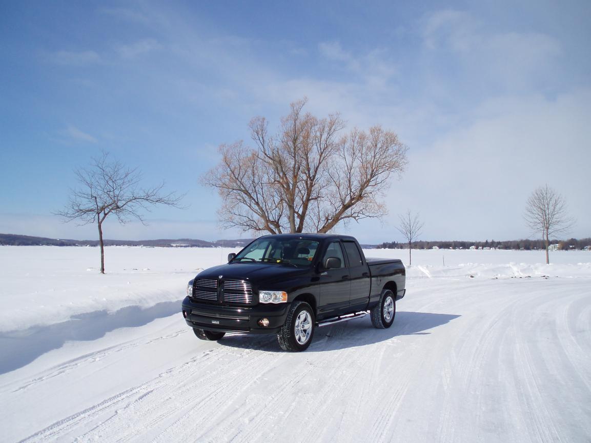

I'm not sure how to tell, but i've been noticing some knocking coming from my suspension from BOTH front wheel assemblies when turning and going up driveways or going over manholes. I can also feel it in my steering wheel. I can't notice anything visually under the truck around the ball joints but i'm not sure just how to inspect em either.
Some background: 04 quad cab with 4x4, HEMI, and 130k on the odo.
If anyone else has had similar problems, what was the issue?
If not, what's the best guess as to my problem? I want to take care of it before it costs me control arms, cv shafts, etc.
Thanks again gang. From myself and Jasmine (my baby).
