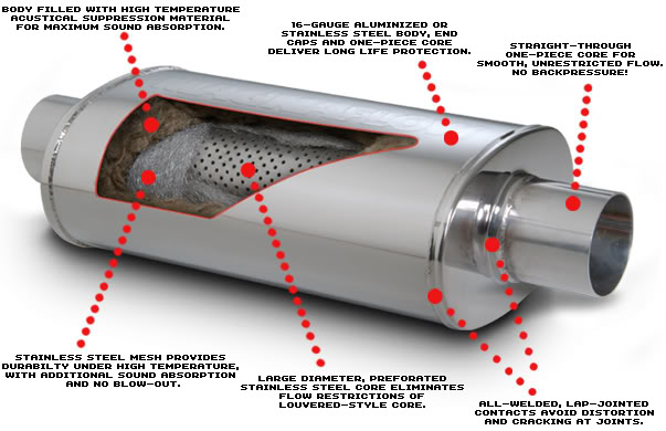

If you're looking for flow then i'll let the pics to the talking...the flowmaster pic is a 40 series delta (supposed to be one of the less restrictive FM's) and the magnaflow is just a SI/SO.

I take it the Magnaflow is a tad noisey then!!!!

i would say the Fm is louder from the pics above. the fins push the air around to the sides and it vibrates around making the fm sound. thats my theory at least haha.. the magnaflow is a straight through design with more or less a glorified glasspack....
