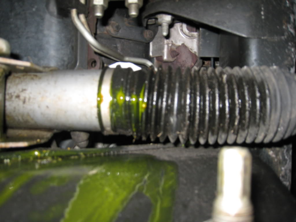

Today I backed outta the parking spot to find that the PS went bye bye completely. Checked the ground where it happened sure enough red fluid all over the place. Boo that noise! So I grabbed a flash light and to my surprise I found this.
Notice anything odd?

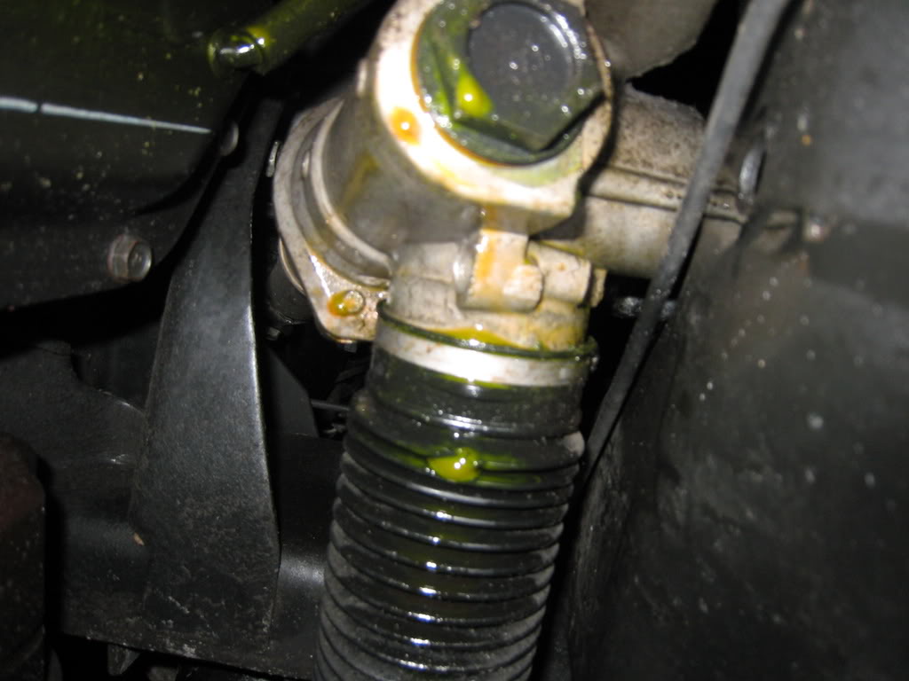

After turning the wheels back and fourth found that the fluid is mainly shooting outta the dust boots for the rack.

So my main question is this...WTF is with this green fluid?
I have a theory going to this. I take my truck to Jiffy Lube for the oil changes, they have always done a really nice job and even taken me down to look under the truck at suspect things sometimes. So I am thinking that mistakenly they put in antifreeze in the PS resevoir. Any thoughts on this. I did some research on green PS fluid and found that some places use Mineral Oil that will have a green tinge. But I tasted this stuff and its pretty sweet, meaning that it surely is antifreeze. I am kinda stumped any insight would be great.
Even if I am completely retarded and this is a common practice to use green PS please tell me now.

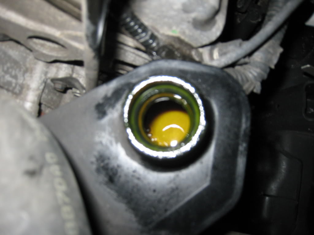

Oh and here is a shot of the resevoir after about a 1.5 quarts of clear chrysler recommend PS fluid.

looks like a teenage mutant ninja turtle climbed up under your hood for warmth and went squish when you started it!
oh man, sorry i couldnt resist. i dont know what to tell ya, but that surely doesnt look right. i would start asking questions at the jiffy lube though. even if they didnt put it there youd think they would have noticed that green stuff in there.

I am sure that you don't find it at all funny but i couldn't help but laugh as i read your story...but there is no doubt that is antifreeze because there is no oil that is sweet even mineral oil. You may be able to save sa lot of money if you can just find the seal to replace in the rack instead of buying a whole new one.

That sure looks like antifreeze to me. But what about Smokey's point...you said its first failure resulted in red PS fluid everywhere? I'd figure if they topped it with coolant, it would be some sort of muddy red-green mix...that shot of your reservoir seems to fit the description.

Yea the whole red to green thing had me baffled to. My guess is that the antifreeze sat on top of the oil, and while all the oil leaked out the next to go was the top stuff. I really don't have a good answer for this. As I did see red fluid in the snow, but to my suprised what the photos show is what I found directly after ther incident.
I am going to put a reman rack in it. $175 my cost through some connections, and I will be putting the MOOG tie rod ends on that rack. So total in parts will be $275 plus fluid of course. I am told to use ATF-4 I did some quick research on here and looks like some people are using that as well. My pops and I will throw it in hopefully Friday. And yes i'll have to get an alignment done soon after that.
Hopefully when we put the rack in I can investigate the green stuff some more to see exactly what happend. Thanks for all the posts guys!
