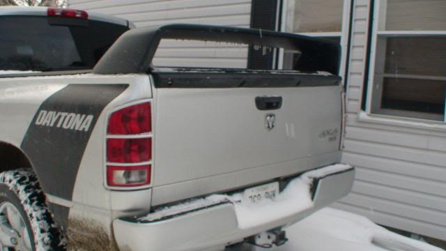

I have the instructions laying around for mine somewhere... but all you have to do is line it up where you want it. mark the holes. center punch it, then drill a pilot hole, and then drill the right size hole, I forget what size. then put in those cush sleeves. mine were a PITA, I still have a buggered up one thats stripped. and then take the tape cover off it and stick it to the tail gate and tighten the screws.
my tail gate bedliner stopped at the right spot and I didnt have to mess with mine at all..
heres a pic of mine istalled
and when you buy the hardwear kit from dodge, it will come with instructions..
