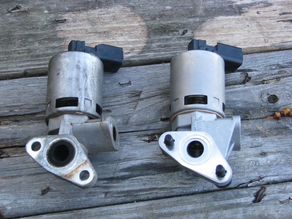

My $25 reader works great for me. I havent tried on an 08 though. $90 for an EGR? yikes, I spent $40 shipped. But yea, an EGR issue with only 10,000 miles wow. When you take it apart you should see if it looks gunked up. If not then it must have been faulty.
bad one on the left, new one on the right.
