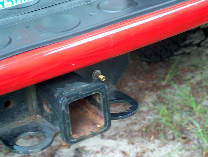

I don't think it much matters. I prefill mine when I'm loading the ATV in the bed, because I know just how much to put in, and because the valve is at the rear bumper, it's harder to get to with the tailgate down.

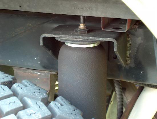

My bags pre-dated my lift 'dog, was not an issue since the bracket goes above the leafs and the lift blocks go below. I had the same concern but in talking to where I got the lift kit from they assured me it would be a none issue.
I'm looking at going to a 3" body lift fairly soon and again, no problem. I picked the brain of the guys at the local 4x4 shop, who looked at it (I feel bad, cause I'm doing the lift myself, but I've recommended them for a couple gear swaps, so I guess my conscience can be clear). The bag bracket goes to the frame, I'm sure you've seen a pic of mine by now, I welded it, but they come with bolts to drill and put in. The poly blocks go over the frame and under the bed, so again, no issue with the bags. You won't have a problem...

No drilling and bolting for me either. I'll weld it on. I'll just cut and grind down if I change out or remove them! They are cheap enough to dispose of when the time comes especially if you've got your use from them.
I haven't seen any of your pics with the airbag helpers? Got any on hand?
Old Feb 23, 2009 | 02:41 PM
HammerZ71's Avatar
HammerZ71
Posts: 24,686
