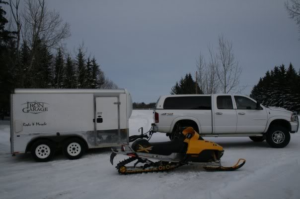

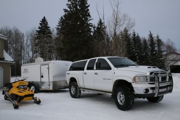

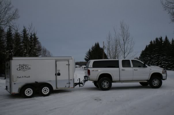

Hello everyone. I just picked up a trailer for my sled and now I have come to realise how terrible 3.73's and 35's are when towing even a tiny trailer with some wind. I really wanna do 4.56's but before I leap I would like to know what rpm the truck will turn going down the highway with 35 inch tires. Right now im at 60mph and turning 1500 rpm. 80 mph nets me 2000 rpm some feed back would be great as to what rpm change would occur as a gear change result. And now for the entertainment here are some pictars. Forgive my dirty truck the roads here are so sloppy.

Hemiguy, nice machine. What size skidoo is that?

can i say truck of the month here thats a nice truck you got going and love the color

Its a 02 Summit 800X

nice setup.
