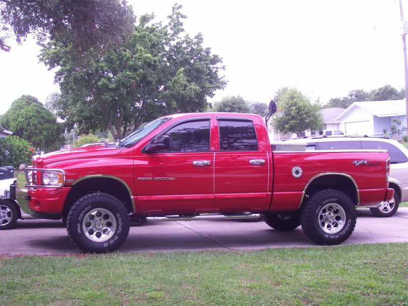

You'll have plenty of room for wheel travel with 4" of suspension lift and the CV angles will not be so severe as to have off-road problems that a 6" suspension lift would give you. My 4" Rancho lift has plenty of room for flex with 35's on 17" wheel and the 4.53" offset gives it just the right stance IMO.

I agree with the 20's for wheelin but I can do wheels right now so I'm stuck with these. Very nice wheels but just dont sit wide enough. I'm just deciding budget wise, keep the wheels, 1-2'' wheel spacers, and leveling kit. Your truck does have a good stance, and those 35's look fine with a 4'' lift. I like a little more clearence than that, but you said a 6'' lift is a little to hard on the cv angle? What are the problems that come with that? I dont know anything about independent suspension. I've always had trail rigs. I know some cheap lifts dont drop the center so steep angle and you ware out the cv's. Are ther 6'' lifts that do a better job for this reason? I know, I know, I'll learn these things soon. I'll do some research.
