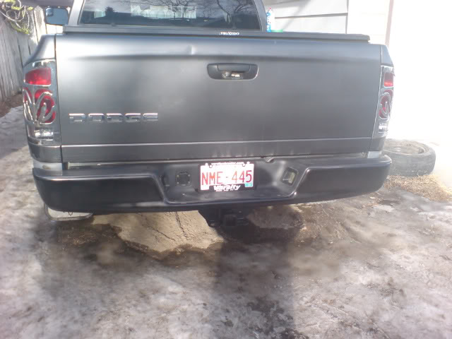

hey i painted my chrome bumpers not to long ago. all i did was take a scotch brite pad and lightly buff up the chrome to give the paint something to stick to. then used some primer, a few coats of paint and some clear coat. It was less then 30$ to do everything. Heres a picture of what i did. as you can see I also painted the rockers and rims black looks 100 times better.

ya as long as you scuff it up it will work and nice job 74 looks good
