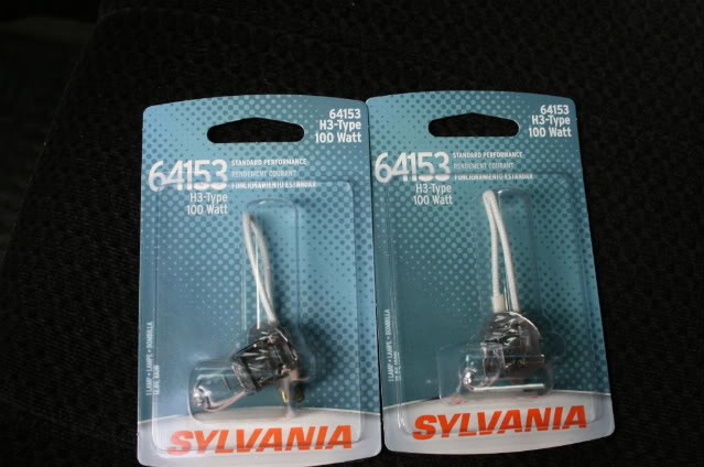

Upgraded to 14 gauge wire to allow for higher wattage bulbs, installed an in line fuse, and upgraded to a 30A rocker switch. My final wiring goes as follows; battery to fuse, fuse to switch, grounded switch to grounded lights. They work beautifully.
heres a couple pics now.
Pictures of the new bulbs, not in yet... obviously

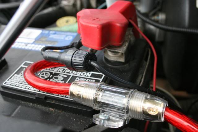

In line fuse with a 30A bulb fuse

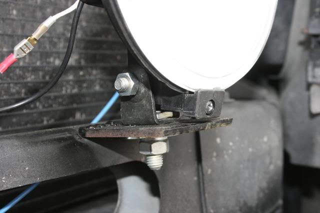

Mount I made to push the light closer to the grill, hopefully help with lighting

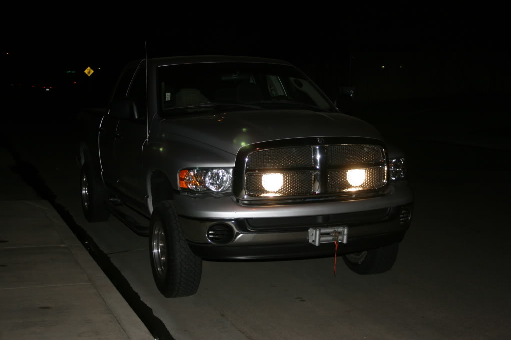

Picture I took last night

The only thing I will change is MAYBE the in line fuse. Dont think I like that style, and Im going to wire loom everything. I have the loom, just havent done it yet. Thanks for looking guys!!!

those look sweet!
