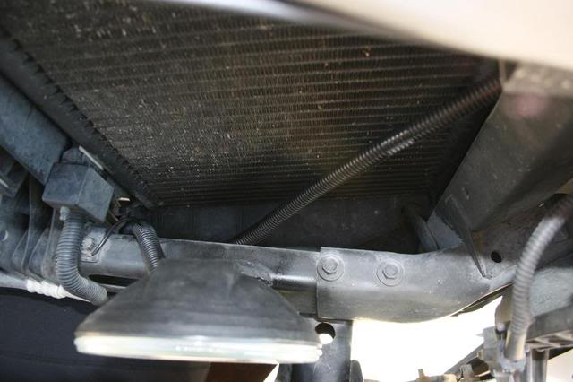

First, here a couple of picture after I put all the wire loom in place, looks a million times better. For those who were asking about wiring loom, its the black ribbed 'tubes' that enclose the wires and keep them safe, and improve appearance.

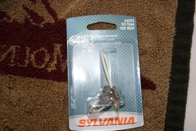

On to it. Today we are changing our 55w lights, to 100w bulbs for better eye performance at night. Also adds 5 HP at WOT.

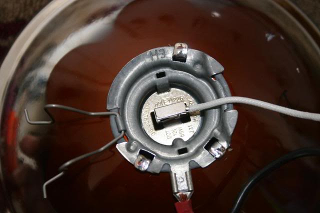

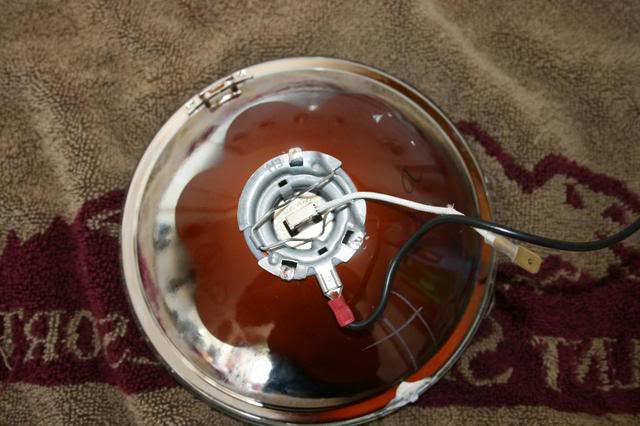

Ok, so pull light out of the housing, just like when you grounded the lights. turn it over, and should get something like this.

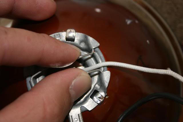

There is a metal spring retainer that holds that bulb in place. Squeeze, and pull the clip out of pockets.
After rolling clip out of your way, pull the bub out. DO NOT TOUCH ACTUAL BULB!!! Any halogen bulb do not touch, the grease from your fingers will heat to 463.8 degrees, and melt the bulb. Not very pretty.

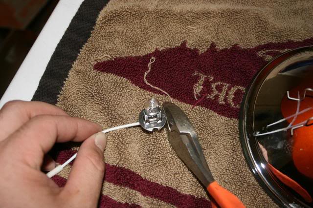

Grab your new bulb. My new bulbs came with a little hump on one side of the round plate. notice on the right hand side of the metal round plate.
Cut it, I did. whats it there for? it wont fit in your lights. i say again, cut it.

Alpheus. My lights are not the FF series. These are the regular 500 series driving lights. At first, I tried to bend the hump up, then realized I was wasting my time with those dikes staring me in the face.
