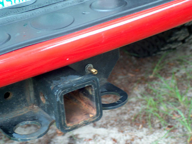

so how do i fill the bags if i dont have an onboard compressor? with an airhose? where is the fill valve located? is the ride any different with no load?

yep, any air hose. You mount the valve wherever it's convenient. with no load, you run with a minimum of air, you use however much air you need to level as you add weight. The set I have provide 2000# level capacity. So that basically means 2000# in the bed and/or on the tongue. Plenty, although they do make 5000# kits.

hammer- i see you mounted your brackets on, is that better than drilling through the frame?

I just don't like drilling into the frame when I don't have to. I don't plan on ever removing the bags, and if I sell the truck, I can't imagine anyone having a problem with the truck having air bags. If needed, everything can come off easily except the upper brackets...
