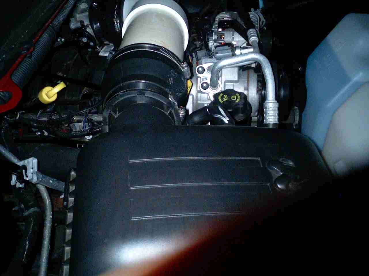

Alright I did it today. I went and bought 2 3 inch elbows and a 2 foot section of 3 inch pvc. I bought a cone filter and and a oil breather filter ans some zip ties
It was pretty easy to put together Me and a friend got it done in about an hour. The hardest part was drilling a new hole for the mass air sensor.
I used a engine resistant paint which did not bond to the pvc very well... but oh well. I would recommend krylon fusion instead.
I must say it sounds louder and has changed my exhaust note on my flow 40 as well. I like it =)

Sorry the pic is kinda dark but its getting late and I used my blackberry cause I could'nt find my camera.
let me know what you guys think. I used a metallic grey paint to try and sorta match my truck

Looks good.

Looks real good! I did that as well, but I have it positioned down a little further. I have a Jet Stream scoop which directs air right to it. Check it out....

I like that rsjibb I may try and tilt mine down a bit i need to come up with a way to support it on the filter end of the pipe though. How did you stabilize yours?
