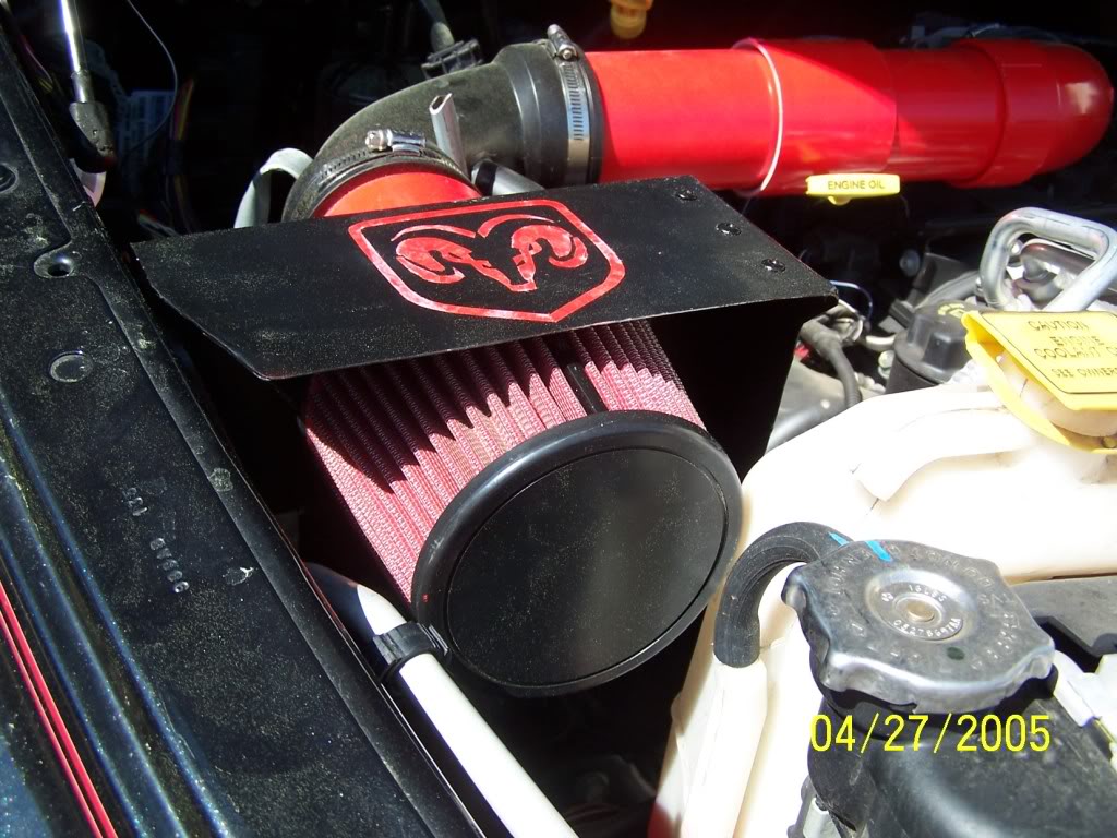

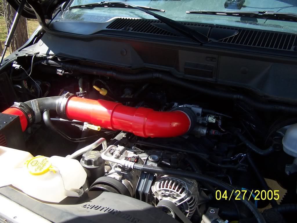

here is mine. and fab up a heat shield! it helps alot!!!
