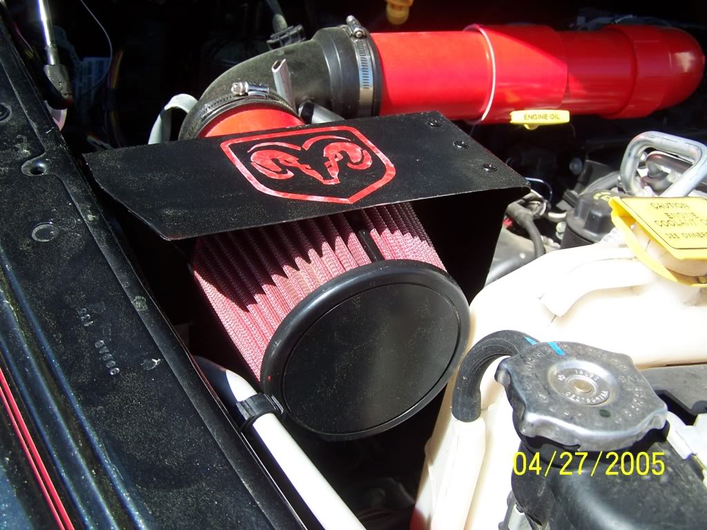

make your own. i promise u will be way more proud of it when it is done. and it really is not that hard!!! and mine is holding up great!!!!!! and sounds amazing!!!!

drill out the hole then wrap the sensor in electrical tape and screw the sensor in. it will stay. and i would drill a hole for the hose. it is adding power not taking away. don't plug it!

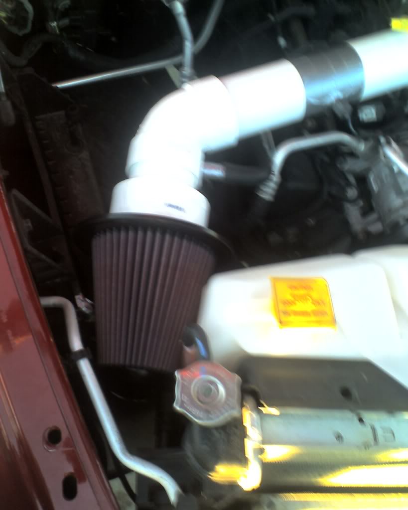

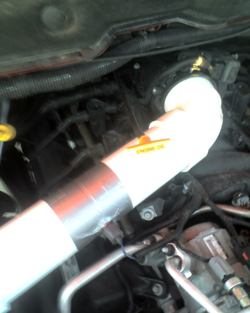

here i mine just finished it yesterday. Got it in white pvc 3" it's half the price of the black. So did a little cuttin some sanding some painting and booooom here it is.. Havn't drove it since yesterday when i was havin whole shot bogs.. After it got going the power was great.. after i installed it i did take the ground off for about 10 min and put it back. Havn't drove it since, Have not drilled trhat hole for the air sensor yet either ..

I really think you need to get that IAT sensor back in and the hose fixed, This should take care of the bog IMO. But it looks good, I'm going to be setting mine up the same way as you did in a couple weeks.

You absolutly need to make a hole for that sensor, the computer needs to know how cold the air is and how much its getting, without that the computer will make wrong estimates and screw everything up.. as for the pcb rubber tube i just bought a metal peice the same size made a hole in the Pvc pipe and screwed it in there and poped the tube onto it... dont really know what the tube is for but if its on the truck and it goes in the air box it obviously needs to be on there.. so use ur imagination and get that tube in your air intake..
