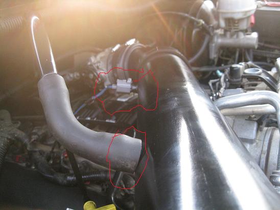

ok here is what i hasve done im about to go drive it also ... I Dc the ground... and i pt those hoes and sensor in the take... heres a pic let me know what ou think

heres some stuff to ponder...would it make a difference what length it is? and what if you put the sensor closer to the filter so it can read a colder temp?...and lastly, what do you think of puttin a fan of some sort inline with the pvc?

Havn't thought much about all that. Sounds like some ideas. Well i just got back from doin some drivin and i got to say everything is runing good. Sounds great. I can feel a dif. Only the driver could feel of course. Think i wanna go headers next.

whatever the temp reads it will change the air fuel mixture...another reason cold air intakes have nothing to do with "cold air". ha. there is a reason for that sensor other than to tell you the outside temp on the dash
